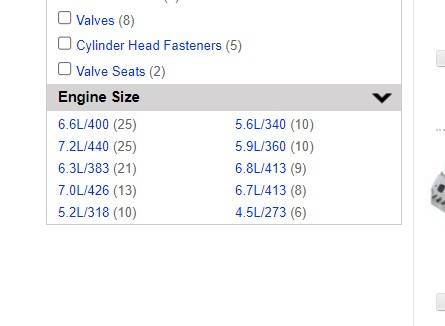

When I search for parts, I see the 413 listed as a 6.7L or 6.8L, how do I know what I have? Supposedly out of a late 70's motorhome.
A 413 is a 413, "Real" American motors aren't measured in liters.
but if you really have to convert, it would be 6.8L
A little google searcing I figure it should be the RB 6.8L

6.77047936 rounds up nicely to 6.8 :)
Of course, 413 was rounded down; it actually calculates as 413.16 cubes which was the number used to calculate the 6.77 fraction.

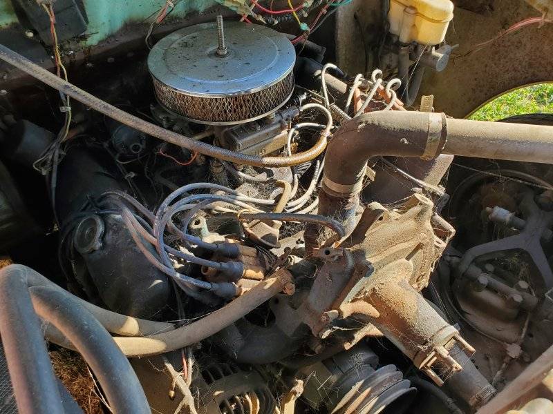

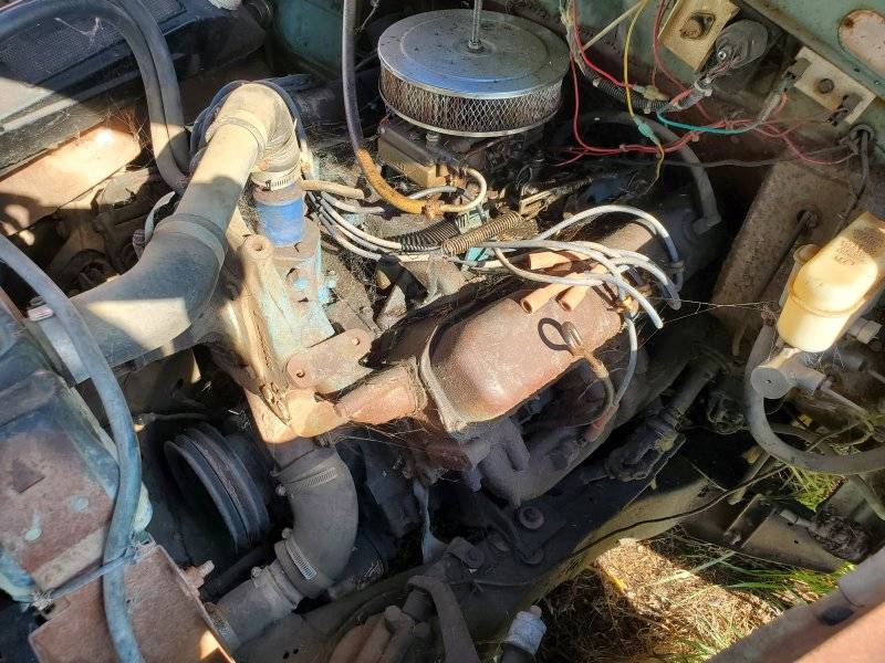

FYI. What you have there is not a passenger car 413. Its the 413 Industrial that was used in RV's, wind machines, water pumping etc usage. Its a critter all by itself.
Block should be the same, Crank will be longer likely, but the mains should be the same. Rods/pistons/rod bearings will be the same. heads have water ports in the end, but any BB head, except Hemi of course, will fit. Intake should work on later heads I believe. Short of pistons, most all of the other internal parts are the same as a 440, so that should open up the search field.
