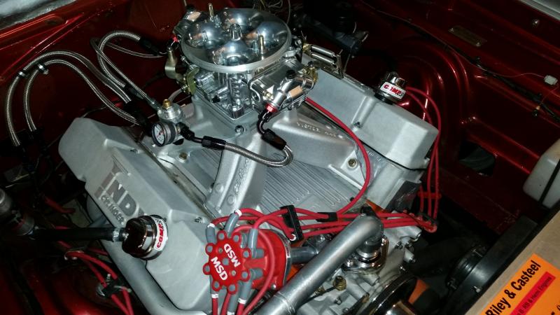

Well, we are on the road to dyno day. I am going to test two 4150 1050 CFM QuickFuel carbs. One has downleg boosters and the other annular. It will be interesting to see what how it all shakes out. Still debating on hitting it with a 250 shot on the dyno. If we have time I'll bolt a Dominator on it for informational purposes.
I'll see if I can dig up a tapered 4500-4150 adapter. Maybe I'll just buy one and blend it in. Either way we will get some info.
The other thing that will be interested is seeing what the Hughes CNC ported Edelbrock Victor MW heads are worth.
See what you started lol. I'll never get this thing to fit under the hood scoop!
Jeremiah ,
could you also throw up your engine specs as well thanks .
Tex
511"
4.375 bore 400 block, aluminum main caps and studs
6.535" Rod, 2.220/.990
Diamond 1.32" CH -12.5cc reverse dome pistons, tool steel pin
Ching chong wing wong crank offset ground to 4.25" stroke, .2.200 rod journal from a Chrysler journal 4.150" crank.
Edelbrock Victor MW heads CNC ported by Hughes and cleaned up a some by me in the chamber and valve job.
Manley TI retainers and locks
ISKY 9999-RAD springs, 240@2.00" / 740@.750" lift
B3R rocker shaft relocation / geometry correction kit.
Hughes 1.7 ratio rockers
Trend tapered 7/16" push rods
Jones custom roller cam, .740ish lift, 280ish@.050
Isky Red Zone lifters w/ EX-roll option, .180 intake offset due to offset intake rockers due to offset intake ports lol
HV oil pump
70-71 "HEMI" 6 qt. oil pan
3/8" pickup
Indy 400-2 intake cleaned up a bunch.
4150, 1050 cfm QFT Q-series carburetor
Monte Smith Big Shot N20 plate
It's all going in my red '66 Charger mated to a G Force GF5R 5-speed backed up by a Dana 60 with 3.54 gears.
Maybe we will make drag week in 2017 or something like that.
