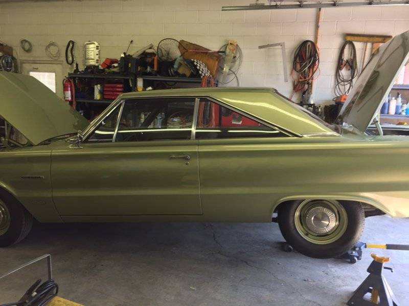

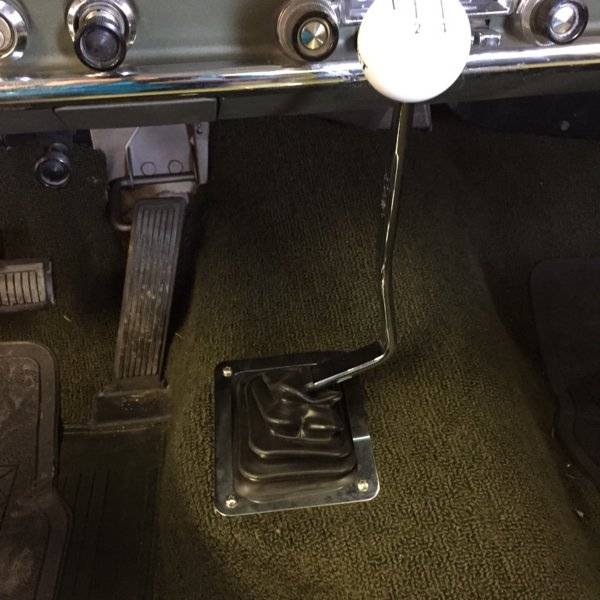

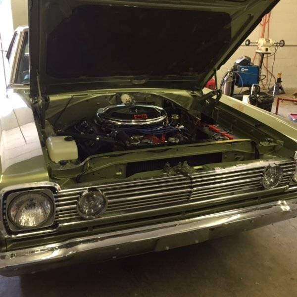

Hi,
I am in the rebuilding stages of a Mopar 426 Hemi Crate engine circa 2002. It will be going into a 1966 Belvedere II Hemi clone. The car has a Dana 60 with 3:54 gears, stock hemi exhaust manifolds, 4 speed manual, and 14" tires with dog dish hubcaps. The motor will be 9:1 compression ratio, stock mopar iron heads, and reproduction dual quad intake with two 600 CFM edelbrocks. Car will be almost 100 % street driven, just looking for that great Hemi sound at idle. Does anyone have any cam suggestions?
Thanks in advance for your input,
Tony K.
Some eye candy for your efforts.
