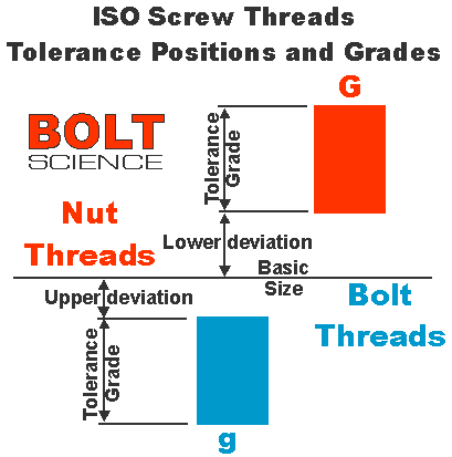

I believe that the blind end of a stud has a different thread CLASS. For example, a class 2A thread differs from a class 2B, even though the thread DIAMETER is the same. Class A is for an external thresd; Class B is for an internal thread. The higher the class number (1,2,3) the tighter the tolerances snd tighter the fit. Just be careful in retapping a close tolerance thread (-3) with a lower class thread (-1 or -2) or you will loose the thread holding power of the higher class thread.
Look up the info below, it will explain in greater detail.
BOB RENTON
From Portland Bolt Company site: www.portlandbolt.com
Essentially there are three different classes of threads, the difference being the precision with which the fasteners are threaded. Class 1 threads are a loose thread fit typically specified for quick assembly/disassembly or for environments where dirt or contaminates may interfere with tighter threads. This class of thread is exceedingly rare, and from Portland Bolt’s collective experience, is virtually never specified or requested. The vast majority of fasteners in the marketplace, and the only thread class that Portland Bolt manufactures, are Class 2 threads. Class 2 threads offer the perfect mix of function and strength, but also efficiency and manufacturing economy. Nearly all construction and industrial fasteners from structural bolts to anchor bolts have Class 2 threads. Both ASTM and SAE specifications designate a class 2 tolerance. Class 3 threads are tight tolerance threads that have no allowance and have very tight tolerances. Class 3 threads are often specified for tight tolerance fastener applications in critical use situations where safety and strength are a primary concern, such as the aerospace industry. Portland Bolt cannot manufacture a Class 3 thread with our bolt manufacturing equipment and a Class 3 thread fit must be created by a machine shop with precision machinery.
was previously stated that an essential principle is that the actual profiles of both the nut and bolt threads must never cross or transgress the theoretical profile. Practically, to make a thread, tolerances must be applied to ensure that this essential principal always applies. Tolerancing of screw threads is complicated by the complex geometric nature of the screw thread form. Clearances must be applied to the basic profile of the threads in order that a bolt thread can be screwed into a nut thread. For the thread to be made practically there must be tolerances applied to the main thread elements.
Usually nut threads have a tolerance applied to the basic profile so that it is theoretically possible for the nut thread profile to be equal to the theoretical profile. Bolt threads usually have a gap between the basic and actual thread profiles. This gap is called the allowance with inch-based threads and the fundamental deviation with metric threads. The tolerance is subsequently applied to the thread. Since for coated threads the tolerances apply to threads before coating (unless otherwise stated), the gap is taken up by the coating thickness. After coating, the actual thread profile must not transgress the basic profile of the thread.
A full designation for a metric thread includes information not only on the thread diameter and pitch but also a designation for the thread tolerance class. For example a thread designated as M12 x 1 - 5g6g indicates that the thread has a nominal diameter of 12mm and a pitch of 1mm. The 5g indicates the tolerance class for the pitch diameter and 6g is the tolerance class for the major diameter.
A fit between threaded parts is indicated by the nut thread tolerance designation followed by the bolt thread tolerance designation separated by a slash. For example: M12 x 1 - 6H/5g6g indicates a tolerance class of 6H for the nut (female) thread and a 5g tolerance class for the pitch diameter with a 6g tolerance class for the major diameter.
A tolerance class is made up of two parts, a tolerance grade and a tolerance position.
A number of tolerance grades have been established for the pitch and crest diameters (the crest diameter is the minor diameter in the case of a nut thread and the major diameter in the case of a bolt thread. Tolerance grades are represented by numbers, the lower the number the smaller the tolerance. Grade 6 is used for a medium tolerance quality and a normal length of thread engagement. Grades lower than 6 are intended for fine tolerance quality and/or short lengths of thread engagement. Grades higher than 6 are intended for coarse tolerance quality and/or long lengths of thread engagement.
There are:
5 tolerance grades (grades 4 to 8) available for the minor diameter of the nut thread.
3 tolerance grades (grades 4,6 and 8) for the major diameter of the bolt thread.
5 tolerance grades (grades 4 to 8) for the pitch diameter tolerance of the nut thread.
7 tolerance grades (grades 3 to 9) for the pitch diameter tolerance of the bolt thread.

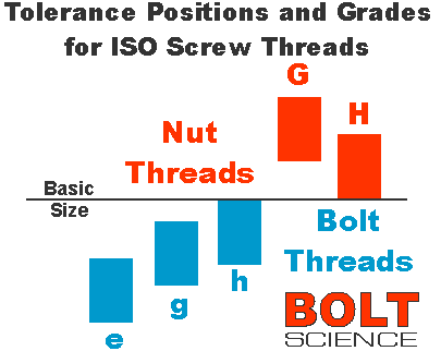

Tolerance positions are indicated by letters, upper case letters for nut threads and lower case letters for bolt threads. The tolerance position is the distance of the tolerance from the basic size of the thread profile.
For nut threads there are two tolerance positions, H with a zero fundamental deviation (distance of the tolerance position from the basic size) and G with a positive fundamental deviation.
For bolt threads there are four tolerance positions, h has a zero fundamental deviation and e, f, and g negative fundamental deviations. (A positive fundamental deviation indicates that the size for the thread element will be larger than the basic size. A negative fundamental deviation indicates that the size for the thread element will be smaller than the basic size.

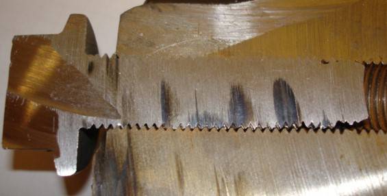

One practical problem that is often encountered is what thread tolerance to apply to a tapped hole. The standard tolerance classes of 6g for the bolt thread and 6H for the nut thread are typically included on a drawing as default. A problem that sometimes occurs is that on long thread engagements (that are frequently used for tapped holes in soft materials) there can be an interference between the nut thread and the screw thread as the screw is rotated into the tapped hole. There can be a slight mis-match in the thread pitch between the internal thread and the external thread necessitating a wrench to rotate the fastener to the bottom of the thread i.e. it can't be freely rotated. The standard tolerance classes apply strictly only when a relatively short length of engagement is used (such as with a nut which is typically 0.8d where d is the thread size). The pitch diameter tolerance must be able to accomodate pitch and flank angle errors which can sometimes only be done by changing the tolerance position say from a H to a G for the internal thread (since standard screws - 6g - are wished to be used). Failure to change the tolerance position can result in thread seizure and damage especially if high speed tools are being used for the tightening process.
An example of such a seizure problem is illustrated below:
