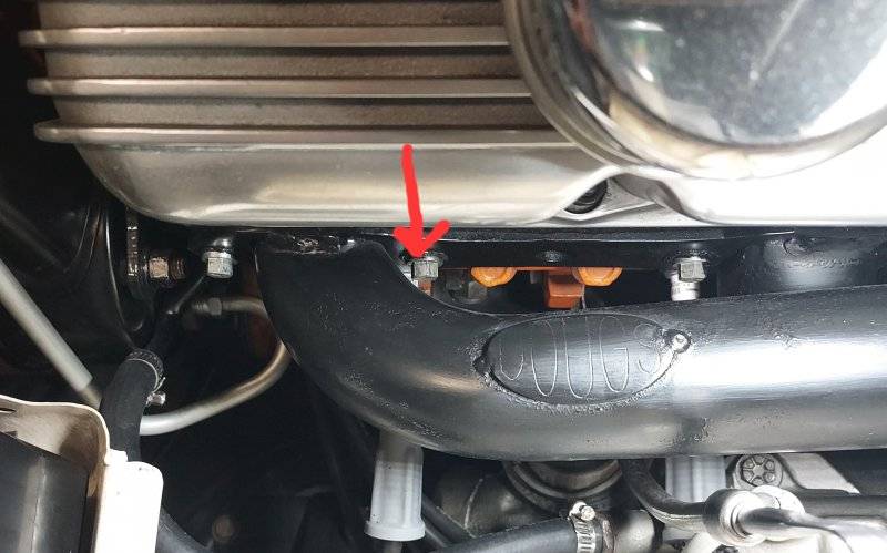

It depends on how long the studs are. On my 452 Doug's it's only tight behind #1 and #2 on the passenger side. Just like when installing the bolts you have to keep the flange pulled away from the head to get these bolts started. Its a 3/8" flange. There is a recess behind the tube at these locations. Like stated use bolts or shorten the stud.
With power steering, studs won't let the header flange go over the studs because of the closeness and you might have to use bolts anyway.
