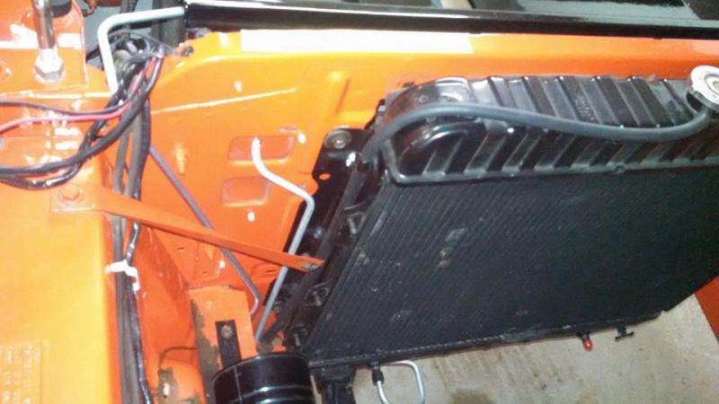

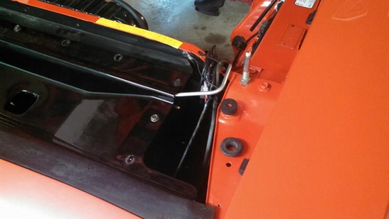

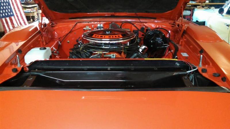

Well, time for more "stuff". Test fitting the auxiliary transmission fluid cooler lines. These are standard equipment on Hemi-auto cars because of the higher stall speed converter used. I found the perfect place to route the one line, through the strength bend that runs along the latch tray. Not sure why Creative didn't put the line there, it fits with a slight bend forward. Guess it was easier hack the latch tray and route the line instead of forming the tube. I may form the tube some more so it approaches the latch tray at a perpendicular direction.

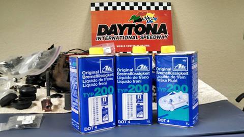

New brake system means new fluid. I went with this very high temp racing fluid. Under the hood of this Daytona, it can get warm....good stuff...

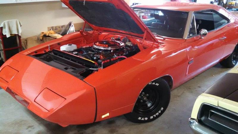

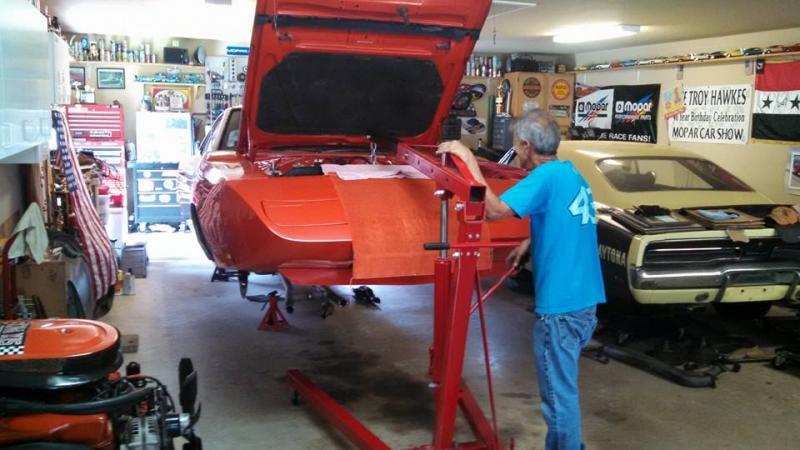

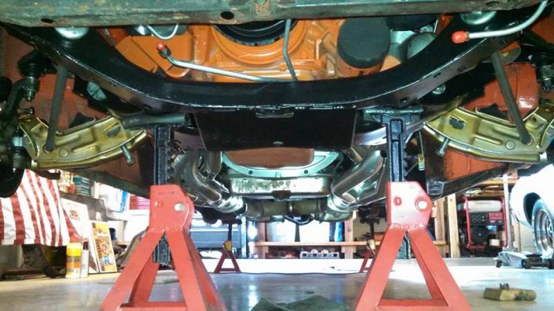

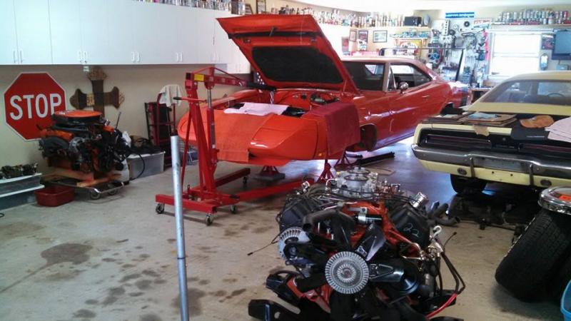

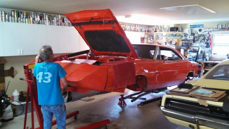

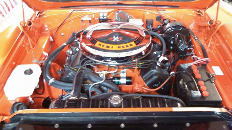

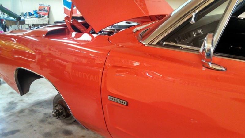

Well, this past weekend, I brought together the 426 Hemi and Daytona. With the help from Tuffy and Jacob, things went pretty smooth. So, finished is a major milestone in Operation Hemi-Transplant.
Lot more to do, but this is one less thing......
positioning.
all clear, finally !!!!
tucked away

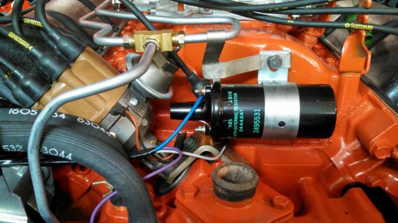

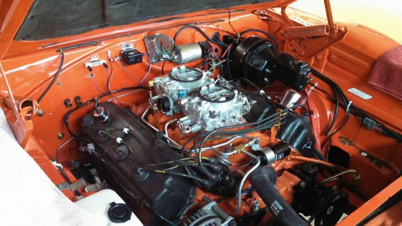

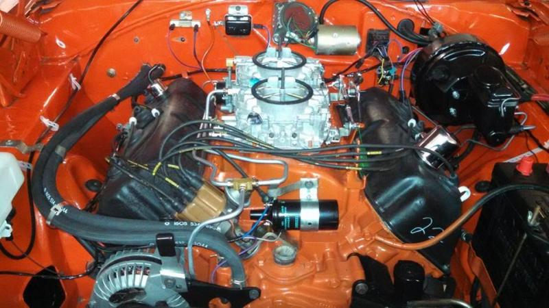

Put together some of the lower suspension/torsion bars, heater hoses with the proper routing and modified the MSD Blaster coil with one of ECS's coil label transfers. Came out great !!! That was for all the guys who pointed out the white lettered previous coil...
More of the coil resto.. The transfer went on very well..
More "stuff" put on.. Heater hoses, etc..

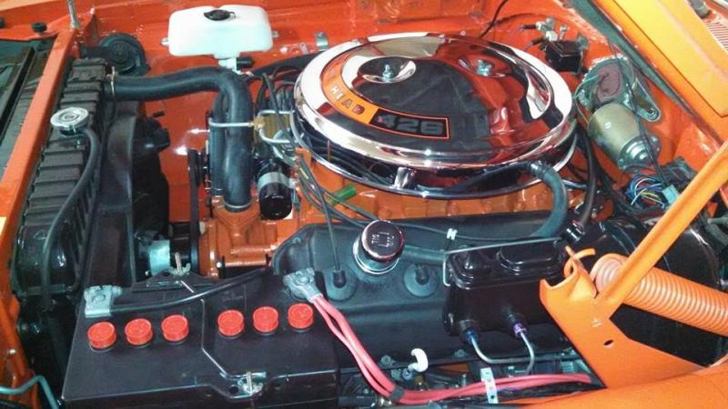

Air Cleaner back on.....

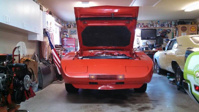

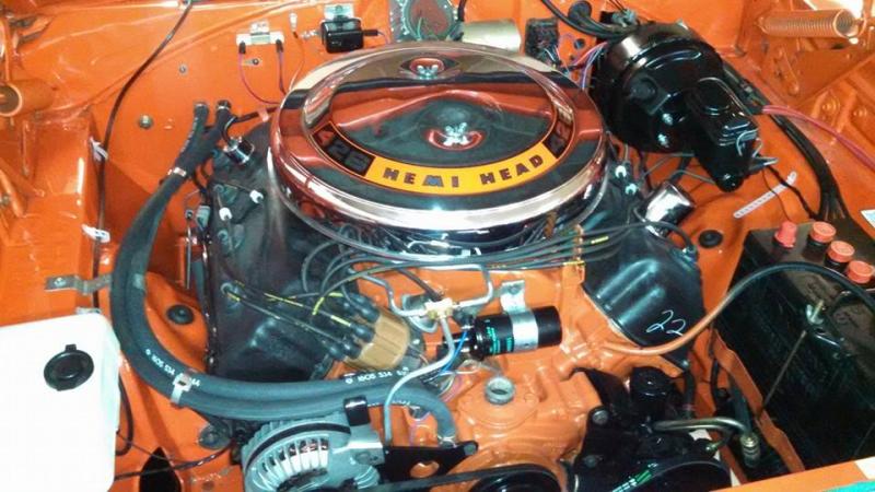

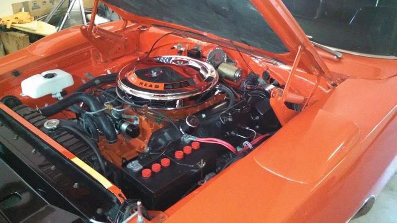

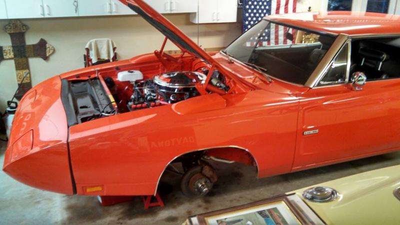

OK...... Project Hemi.... Got more done this weekend.. Change out the oil with VR1 40, lowered the car and adjusted the torsion bars, finished the ignition wiring, put the NASCAR rims back on and odds and ends. It is getting closer...
Back on the ground..

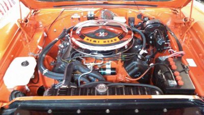

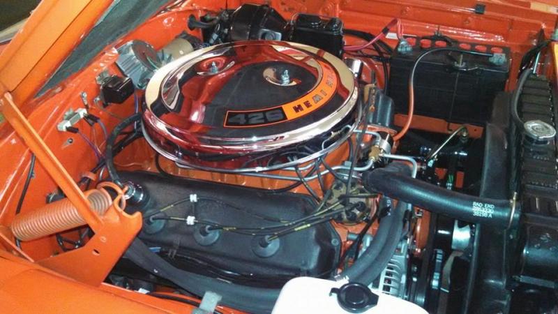

Engine bay closer to completion with hoses and gaskets here and there along with changing out the oil.

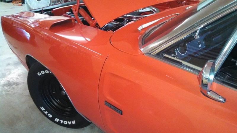

Hemi badge with "hint" of 426 Hemi from chrome dome.
straight on,
Looking down..
passenger side
driver's
