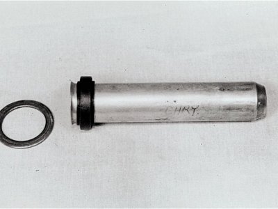

Hi
There is a seal at the bottom of the tube
Sometimes it leaks...
Mancinni Racing sells them
As does Bob Mazolinni Racing
NOTE: The O-ring seal kit is $15.00
The "Blue" seal kit is $150
(I hope this helps you)
Shouldn't there be an o-ring at the top of the tube too?
As I showed in the Pic # 1 Cranky
Pic # 2 is a more complicated set up and sell for 10X the cost of the O-ring set-up
The O-ring "seal" kit sells for $15.00 at Bob Mazolinni Racing
That is where I bought mine.

DUH
How dumb am I
Yup
