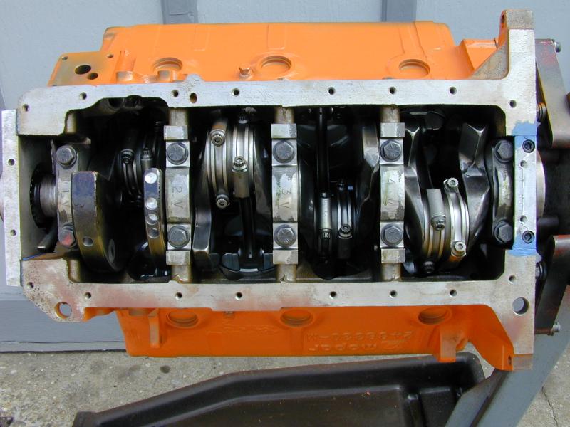

that your block hemi itis?
4 bolt mains and rod studs but no main studs and they look like stock main bolts
my first block i ever put back together i used the original bolts and broke 1 on the main and 1 in the head lol pain in the ***

I guess somehow you missed the cross bolts. lol

Those are 12 point rod bolts, not studs. The divot in the head is to produce a measuring point for the streach guage.

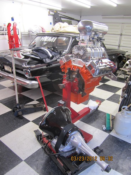

The main bolts that came with the block are stout!In that picture you see a Bryant billett 4.5 stroke gun drilled and knife edged,all the little crank tricks were done.I received this crank in a car sale,he paid cash and some hemi parts.Was a used fuel crank and had to install a converter register on the back.It also wears Manley "H" beams with ARB bolts.Diamond pistons swinging on that one
