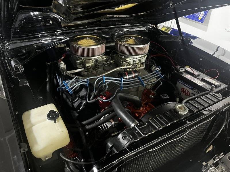

68 426 Hemi with lash caps hyd cam orig heads. keeps throwing lash caps off. Any Thoughts. Thanks Dave
