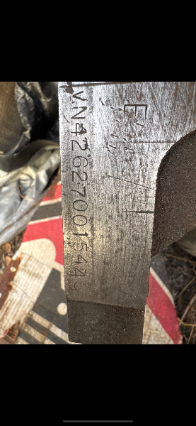

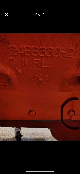

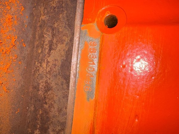

Found a 426 Hemi Engine trying to see if I can find out what vehicle it came out of casting #2468330

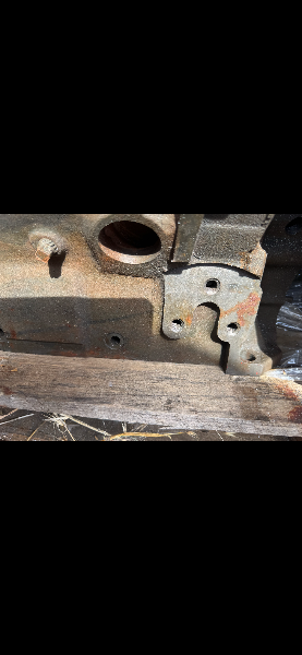

No Vin car is long gone, can’t see the stamp on block I’ll see if seller can clean tag on block for better pics

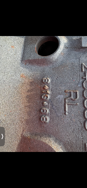

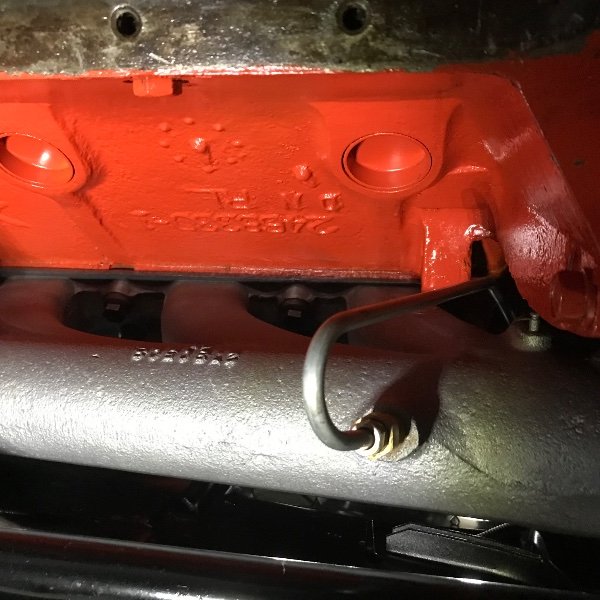

66-67 had no vin stamp. Cast date should be on the opposite side of the block from the casting number. If it's got a vin number, it will be on the pad on passenger side lower edge of the block. The pad on the top of the block to the drivers side of where the intake sits will have additional information, as in year and build date, etc.
