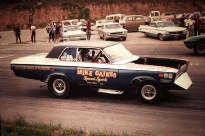

View attachment 299054 20110624_29.jpg20110624_60.jpg20110624_65.jpg20110624_64.jpgmtr frt seat.jpgWhen I was 21 years old I bought a brand new 13.5-1 Max Wedge Aluminum front end car. All anyone had back then that you could buy for the car was premium leaded gasoline, which I did.
I drove the car on the street on occasion (just to show off)...kinda impractical because it had no heater, no defroster, no windshield wipers....but...when I went to the drag races I just used pump gas premium. We would try to find a Sunoco Station because it was perceived to be better...but I raced the car for 3 full seasons using pump gas leaded premium...then in 1966 I altered the wheelbase, installed a tube front axle, set the engine back 26", Installed a Crane Roller Cam, Vertex Mag AND HILBORN FUEL INJECTION AND RAN 80% NITROMETHANE AND 20% ALCOHOL....ALL WITH 13.5-1 PISTONS..raced it all during 1966-67-68 and never lost a motor.

View attachment 299054View attachment 299055View attachment 299056View attachment 299057View attachment 299058View attachment 299059When I was 21 years old I bought a brand new 13.5-1 Max Wedge Aluminum front end car. All anyone had back then that you could buy for the car was premium leaded gasoline, which I did.

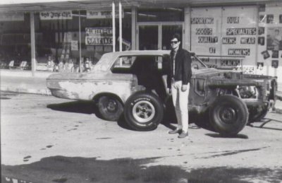

Shifter pix.jpgb  body 65 bl windows.jpgstart line 2.jpgAlt in process.jpgpixs 2 of parts.jpg

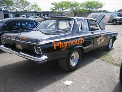

I raced it in 1963/64 and 1965. In the winter of 1966 I sold the aluminum fenders, hood and front bumper to Arlen Vanke in Ohio. (Note: This original front end is still in existance today as I had marked the inside of the fenders, etc with a special mark plus the aluminum front bumper had a little "dent" in it where I had a tow bar accident in 1964.
When I was at the Mopars at the Strip meet in Las Vegas 2 years ago I was talking to a guy who said he had bought his 1963 aluminum front end from a fella who said it had been on Arlen Vanke's NHRA class record holder car. I was standing right beside this fellas 1963 Plymouth at the time. I looked down and saw the dent in the front bumper and then checked the inside of the fenders and hood for my markings from about 50 years ago...wow...they were there and this was MY OLD FRONT END on this car.)

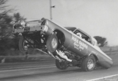

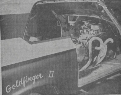

Back to what I did with the car....(and I did all this work myself in the shop at the back room of my Speed Shop) After I sold the front end to Arlen Vanke I replaced the front end with 1965 Plymouth Fiberglass Fenders, Hood, Front Bumper and stock front 1965 Grille. They bolted right up to my 1963 inner fender wells. I also bought 1965 fiberglass doors and 1965 fiberglass deck lid...they all interchanged also...so I made the car look like a 1965. I then altered the rear wheel base 15", altered the front wheel base 10" forward by installing two leaf springs and a CAE tube front axle with 40 ford front spindles. I then cut out the firewall,etc, and moved the engine back 26". Fabricated the aluminum interior, roll cage, shifter, steering gear, headers, etc, etc, I even bought a big piece of plexiglass and made a plexiglass front windshield using a little bottle torch to heat it and wrap in it. I drilled holes around the perimeter and screw it in. The car weighed about 2500lbs when done. I ran just a little motorcyle battery to power the gauges, I had a VERTEX mag so I didnt need a battery or alternator. We merely had the batteries on a pushcart and plugged them it to start the car. I had no radiator but ran heat heater hose from where the water pump normally bolted onto the front of the block back to the trunk where I had a 3 gallon Moon Fuel Tank with an electric water pump to merely "circulate" the water. We drained the tank on the return road after each run and put cool water back into the tank. We usually did 3 burnouts thru the powdered rosin and then refilled the front mounted Moon tank with a fresh fill on Nitro and were on our way...those were the days . Usually got paid between $250 to $300 for best 2 out of 3 win or lose.
Shifter pix.jpg b  body 65 bl windows.jpg start line 2.jpg Alt in process.jpg pixs 2 of parts.jpg
Mike - is this the car your front end was on at one time?

I like that center shifter Mike!!
How fast was the AWB on nitro??
