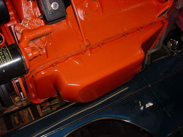

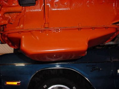

Here is an original Max Wedge pan,any 62/65 big block B-body pan will work without notching the K frame.You need 5 1/2" from the sump to the front of the pan.
