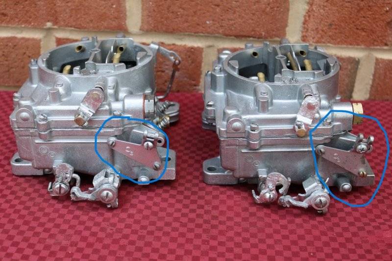

My choke cable bracket is not like this 3 bolt type. One of my issues is my holding bracket for the cable uses 1 screw and comes loose too often so I tend to not use it. I'll have to check if my carbs have these 3 screw holes, if so then try to find this style of clamp.

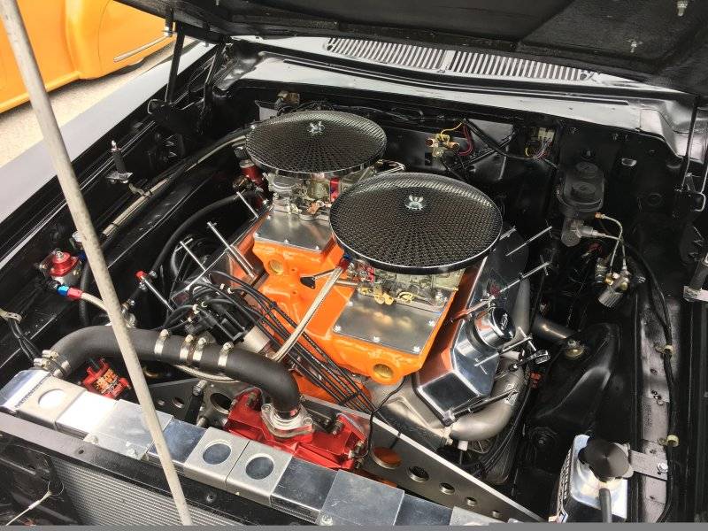

everyone I've owned r that way, the only exception is the 1 i have now thats been modified, carbs r moved inboard 1 1/2" and raised 1" and using hemi crossram holleys. locked timing at 35. starts easier but i hold the throttle until the temp gauge hits 100 and then it will idle on its own and the hotter it gets the faster it will idle and i have it set at 1400...

Anyone have any suggestions to find the cable brackets

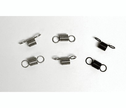

Had the same problem on one of my vehicles. It was the ditributor springs. Changed them out and problem disapeared. I have 5 crossrams and they do take a few minutes to warm up, but only a couple before they run great. The hemis take a little more time than the wedges. Try thos springs! Getting old and it was a few years ago but i cant remember if I went lighter or heavier, but it cured the issue.
No springs, distributor is locked
I have found that not to be the best for street applications and street manners, including idle warm up. You might want to just try another distributor? My vehicles range from 550 to 725 HP and no issues. Knock on wood! LOL
