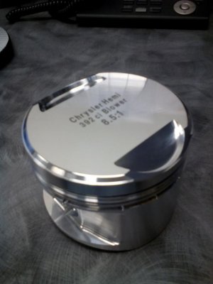

We can build you some really nice stroker pistons at my work (CP Pistons). Have made a lot of Mopar pistons here. Can discuss further details with you on your combo and options. You can call me at (949)567-9000 and ask for Mike in sales. Just a sample pic below of some of our work and one of my NHRA s/s customers in action.
