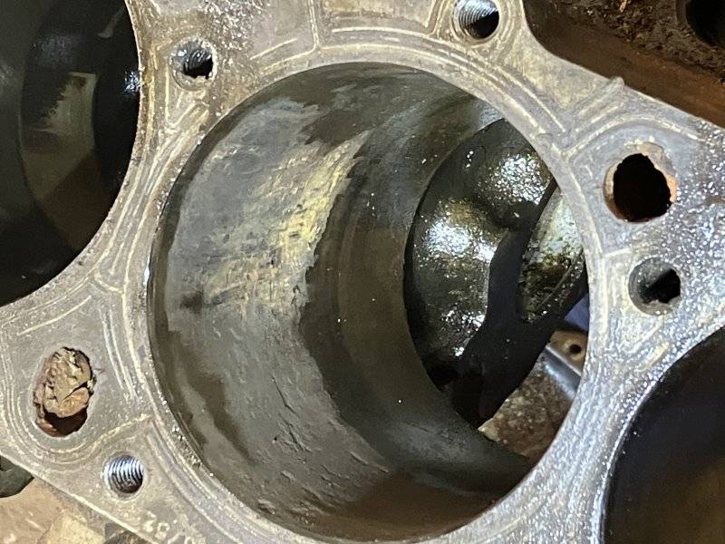

If the pistons are that stuck, how bad do the lifter bores look?
Honestly not bad at all, the lifters kept the bores safe, and I was able to just pop em out. Its weird, you wouldn't expect such a fight from the pistons with everything else that is nice and fine
Sounds good, did it just sit with water in the cylinders?
