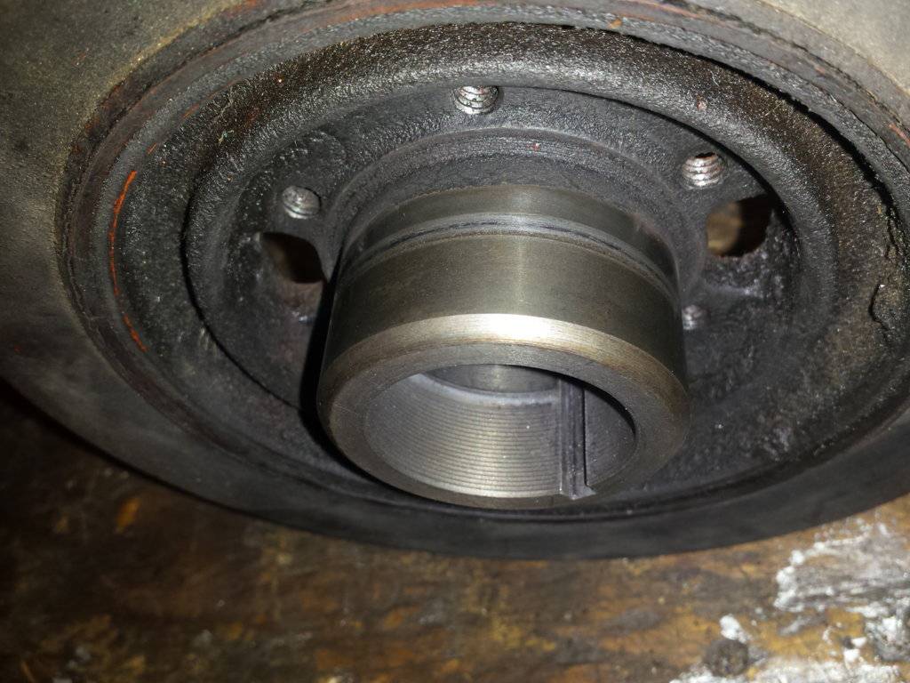

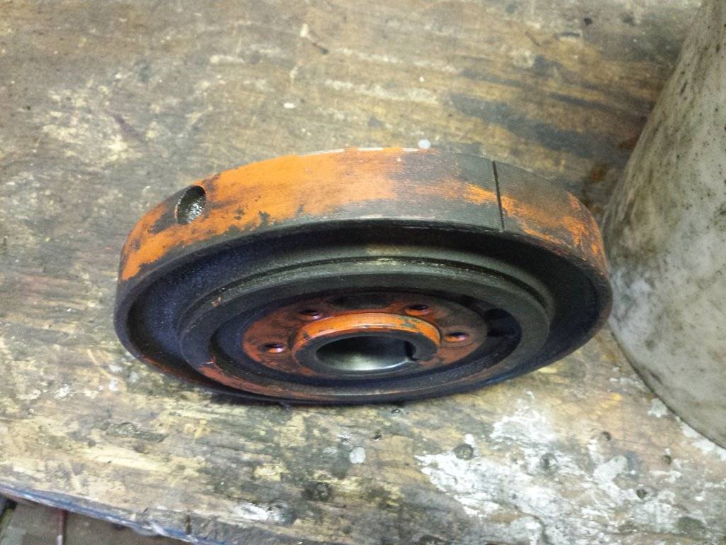

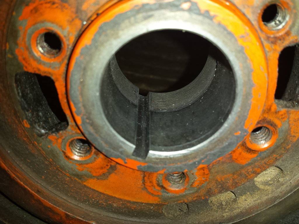

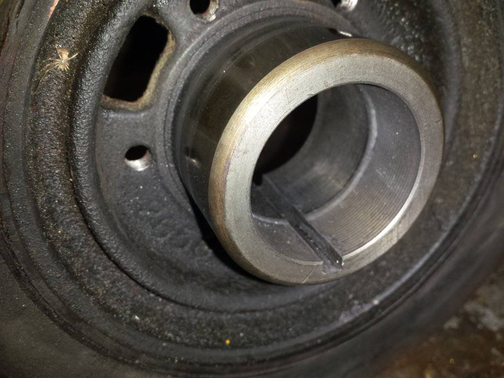

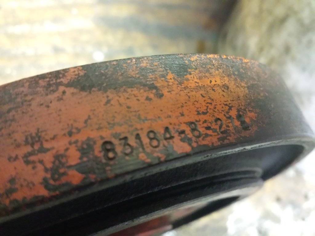

Here are a few pics you asked for. The wear on the snout from the front cover seal cannot be felt with my fingernail.
Get a new dampner or s speedie sleeve at Napa.
