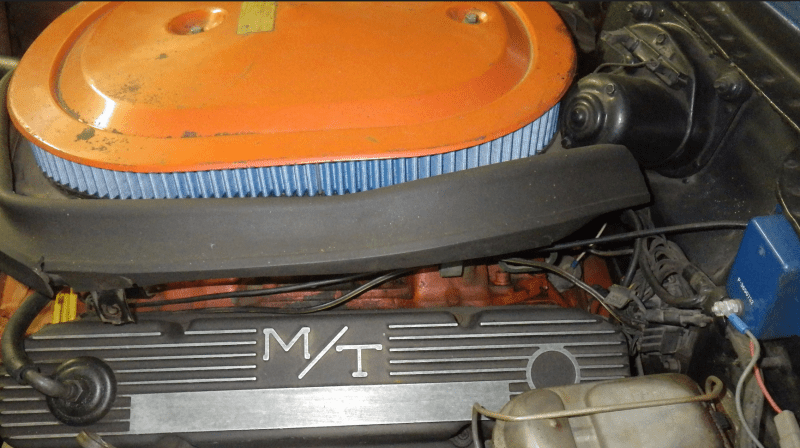

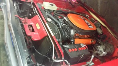

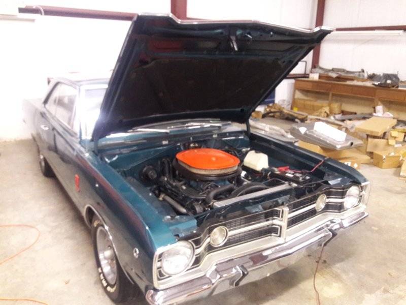

That's one I haven't tried, but it fits under my 68 Dart GTS hood just fine. View attachment 919804
From the photo, it looks like it fits well below the hood. I'll bet that thing goes like hell. Barracudas must fit the same. What others have you tried? I have tried 70RR and 1966 Chrysler, they fit. I assume all '68 and beyond fit. I wonder about the early B's, they appear to have tall engine bays. I'm 400 miles from civilization and never get to see 6 pack conversions in car shows, so I wonder which ones can work.
