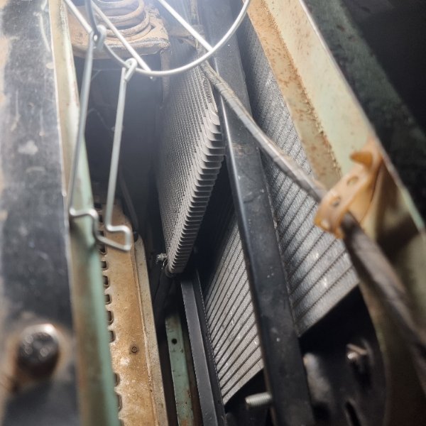

I ended up doing a full top end rebuild and the car was much better but still running 210 on freeway ( used to be 230 in summer, average of 86f ambient). I had to run thermo fans on freeway to keep car at 210 even with new head gaskets.

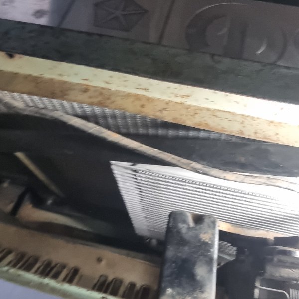

I Finally tried something I always thought would help but didnt think it would have such an effect.( hadn't tried as was always going to be a big job).

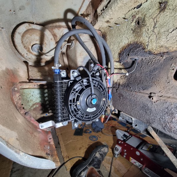

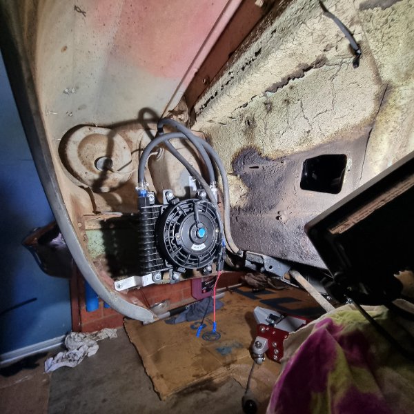

I removed the auto trans cooler and mounted a new unit with thermo fan under the left guard.
The engine radiator now has a full blast of air across it, instead of a third of the cooling area having hot trans cooler air going through it.
The car runs 18 degrees cooler on the freeway at least, and only goes above 200 when I shut it down and restart within 5 minutes.
It is now driveable in traffic( doesnt go above 180) and sits around 190 on the freeway.
Thought this could help someone out there to see how much temp drop can be gained by removing an auto cooler in front of the radiator.

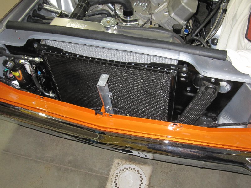

My car has aftermarket aluminium radiator with no built in cooler. I think it's fairly standard to add an additional or separate trans cooler in any performance applications. Most are mounted on front of the engine radiator. In my case the system didnt have enough capacity to cool both radiators effectively.

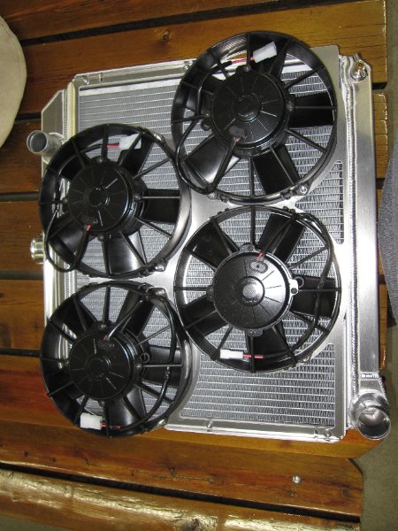

I already have a maxed out radiator custom built by Wizzard and A/C so I did not want to add any extra heat up front. I also have a PS cooler up front but not in the radiator air flow path.
