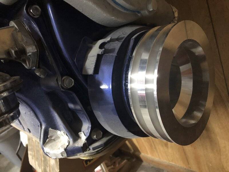

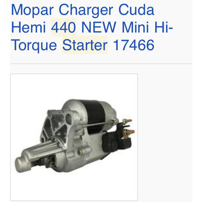

I have a 1978 cast crank 440 Bored 30 over, I think 30/30 crank might be wrong, and mild cam ....Which is externally balanced due to cast crank and harmonic balancer. I was wanting to know what torque converter and flexplate I need? Also what’s the difference btw having teeth on flexplate and having them on torque converter? Also I have already bought a mini starter for it but will that effect which on I need teeth on, and or what size of torque converter I can have? I haven’t gotten a 727 yet but I know I want an automatic.
You need to know what cam you have that will help you to know what stall you need on the torque converter. Others that are more smartererr will chime in. But essentially any big block mopar 727 torque converter should have the same teeth and the mini starter should work either way.

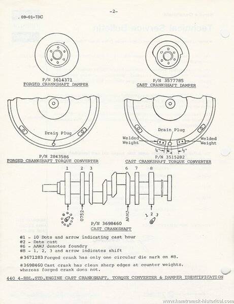

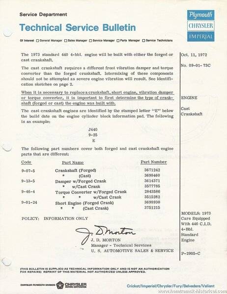

Externally balanced engines will have a significant weight placed off center on the harmonic absorber and flywheel. If your flywheel just has the normal drill pecks in a couple of places then it might be safe to say it's internally balanced. I am also unaware of any 4340 cranks requiring external balancing. From meep-meep.
all cast crank 440's are externally balanced. the big fat balancer is usually marked . that also means it came with 2 20gram weights welded on either side of the drain plug on the converter. as mentioned, you can also use a flex plate that replaces the weights on the converter and use one without weights. get you a 10" converter.
The B&M counterweight flexplate is a good choice. It allows using any neutral balance converter with any of the different bolt patterns.

Mini Starter, no problem, just need to remove the off-set connector/adaptor piece.
Best to connect starter wires before installing the starter because they sort if face the block.

the V8 Dakota style "mini starter" works on any V8
that are Small block LA, Magnum or Big Block B-RB
(except new gen. 3 & up hemi's)
sometimes if the starter isn't clock-able,
you may need to trim down the main 1/4" 12vt stud,
so it doesn't contact the block & able to get the battery cables on & off
without removing the starter
as said multiple time here already
with automatic 727tf/904tf etc. the starter ring-gear
is on the torque-converter, both on BB or SB

many externally balance engines
are balanced with weight on the TQ &/or harmonic balancer ecentric
you can use a full circle flex plate (not a flywheel, that's a 4 speed or manual)
like a B&M, the starters "ring-gear" is still on the TQ, not the flexpalte
(if you use a neutral balance torque converter,
from/intended for a steel crank equipped 383, 440 or 426
& have a cast crank in your 440, all cast cranks are externally balanced
unless custom "internally" balanced at the machine shop
the external balance full circle style flex plate,
like a B&M also
(has a 6 bolt crankshaft pattern, has 8 holes, 2 pairs of 4, for different size converter bolt patterns)
will have a half-moon chunk out of it for the external balance,
for an external balance, cast crankshaft

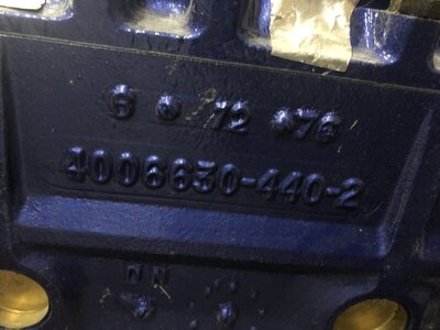

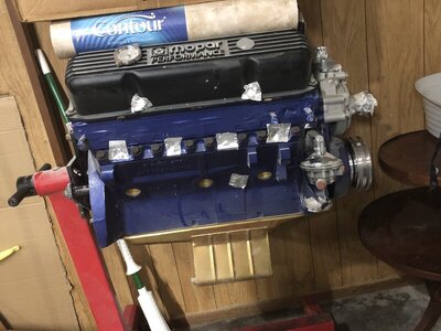

Sorry it’s a 1976 440 going in a 1972 satellite that I’m putting a 8 3/4 rearend in with 489 third-member with clutch sure-grip, 3.55 gears, 1350 yoke that I bought from dr diff, and have hooker headers. I don’t currently have a 727 yet and a lot of other parts but working on it. Just trying to educate myself on what I need or what is best. It has a mild purple cam but no 100% what it was bc I bought the 440 a few years ago and can’t remember.
22EED369-A78B-4C2D-BD6E-625F8E58E780.jpeg B3610598-05A0-4A34-AB77-7BA2E518FA39.jpeg 72DBB673-5609-4B56-8F66-24664E7B12BF.jpeg
can you check the lift on the purpleshaft
a lot of the purple shafts used the same spring- check it out
any idea what your cr and cranking compression are/ were?
I think it was 8:2:1 but not 100% sure
