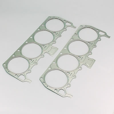

9.5:1 is better but 9.0 isn't terrible. Steel shims are cheap from Mr Gasket for what its worth. If the heads are freshly milled I'd run the steel shim.

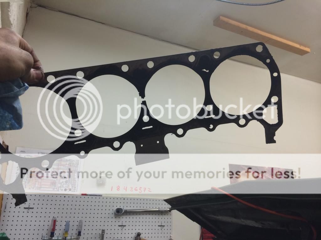

I'm not an expert, but when I was researching and deciding on my build, I planned to use steel shim head gaskets. Somewhere along the way, I read about gripes with overheating and blown steel shim head gaskets. It had me somewhat concerned so I looked further into the complaint and maybe i'm being paranoid or it doesn't make much of a difference at all but this is what I found.
Here is a 60's-1970 Big block coolant passage look like
This is what a 71+ Big block Coolant passage looks like.
When you look at a Mopar Performance or Mr. Gasket steel shim head gasket, it has a very small slit in the gasket itself, these match up the the "figure 8" passage that is in the 71+ blocks, which Chrysler enlarged for better cooling.
If you have a early block, and you place mopar perfomance or mr. gasket steel shim head gasket the aforementioned slits will 80% covered.

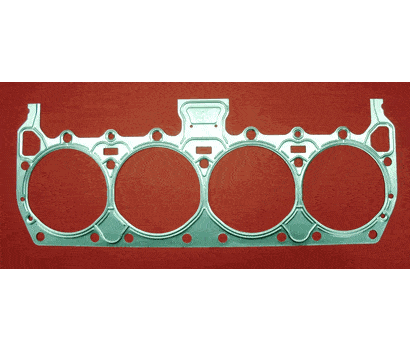

Here's what the Mopar Perfomance one look like

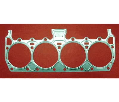

Somewhere along the way, Greg at superformance got a hold of the old direct connection steel shim head gaskets that were factory replacement for early blocks. He created a die and this is what it looks like. Notice the rectangular cut out. Now if you pop that on, the coolant passage on the block is not blocked and matches up well the the passages on the cylinder heads.
Here's a link to the superformance head gaskets.
