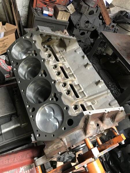

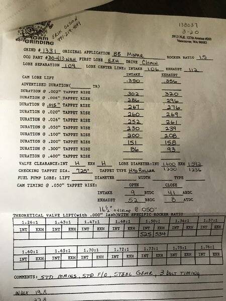

Short block done. Toth performance head in process. Time and money. Lots of money...

What piston are you using?
