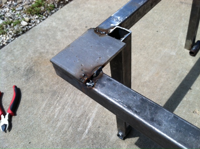

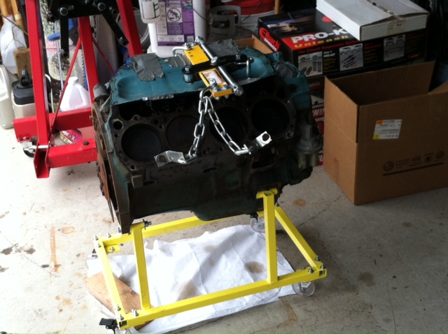

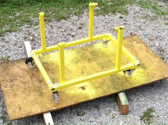

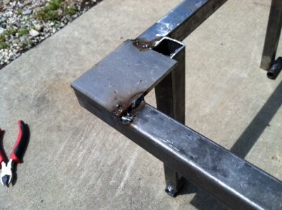

My son and I made one out of 1" sq. tube and 3" x 3/16 flat stock from Home Depot and castors from Cradle build 3.JPGCradle painted 1.JPGCradle with engine.JPG HF.
