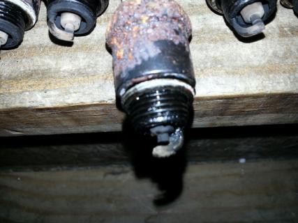

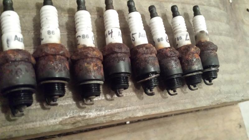

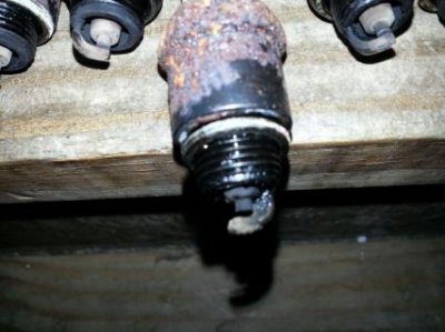

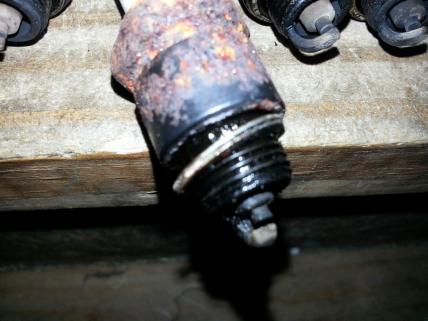

Well, finally got a chance yesterday afternoon and here's what i found, inspected each plug, 3 of the 8 were finger tight, #5 ground electrode was bent slightly and has heavy residue built up on it. Cylinders Compression, cold engine... #2,130 #4,120 #6,120 #8,130 #1,130 #3, 130 #5, 140 #7,115. Replaced plugs, cap, fuel filter and rotor. Ran better but still had a initial bog and a loud whistle off of idle. Carb is a 750 edelbrock that has been sitting so easy fix, i went out to my 455 buick gs project and stole the 770 holley street avenger off it. A little more responsive but but still had the whistle when id give it some gas off idle. It has a stock 4 hole dual plane intake. One of the previous owners, at one time, put a 3/8 aluminum spacer on it, when i changed the carb i noticed it was a open spacer not a 4 hole. Installed a 4 hole 1/2 phenolic and what a difference. NO WHISTLE!!! and the response is incredible motor runs excellent and a ton of power. The excessive blow by stopped out of the valve cover also. Only issue i have left is at about a steady 2500 rpm there is a rattling/ticking sound when i give it a slight bit of gas but as i push on the pedal more it goes away. Im hoping for the fuel pump push rod on that one. Any input would be great. Anyway thought id share what i found for others with the same issues. Thanks for the replys.

Squirt some oil into the cylinders and see if the PSI numbers come up. If they don't, valves are probably leaking. If they do, rings are weak. Does it smoke on start up and then cleans up? If so, valve stem seals are shot but the plugs like rings are probably going away. Bad stem seals can contribute to that look too. Do you any other history of this engine? Original to this car?

What Cranky said on oil in the cylinders, then re-check the numbers. Should also have the carb throttle plates fully open, when you do the compression check. Let each hole hit three times.
