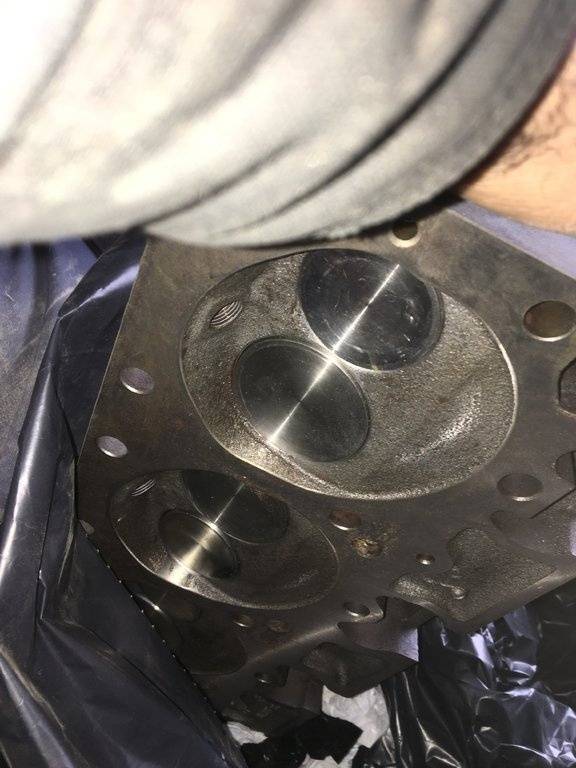

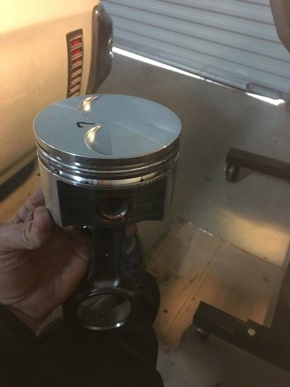

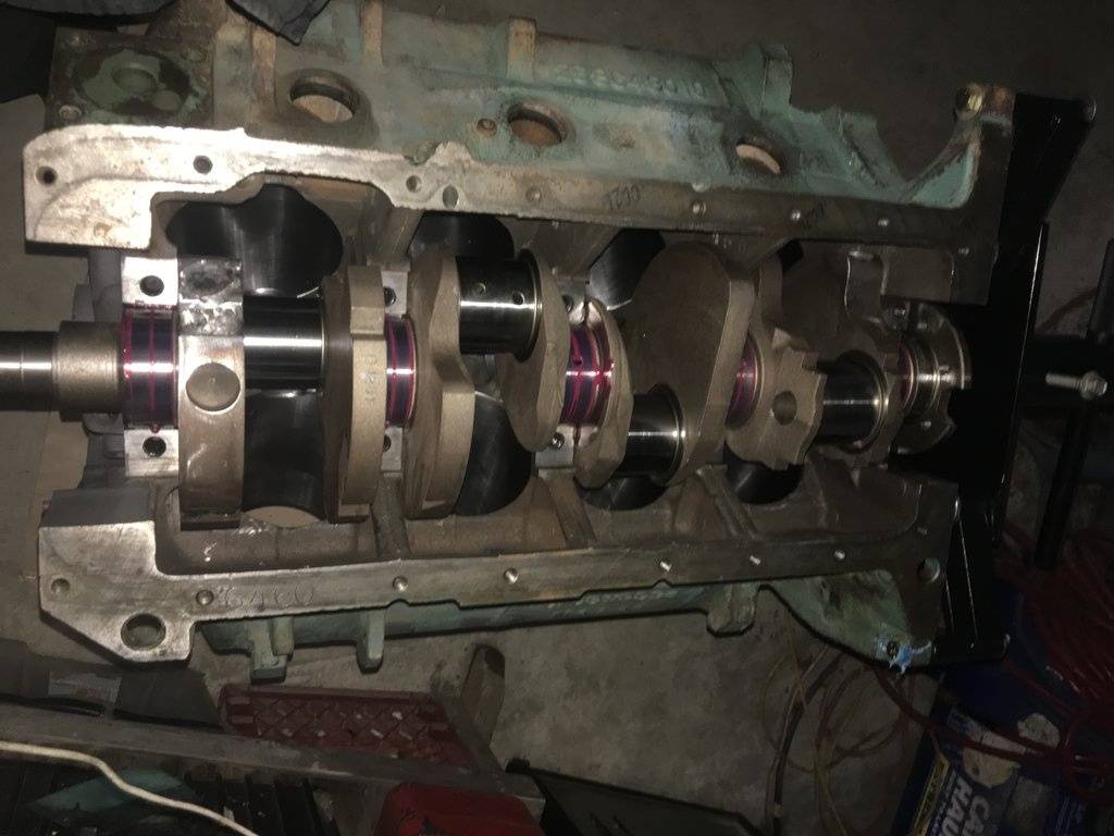

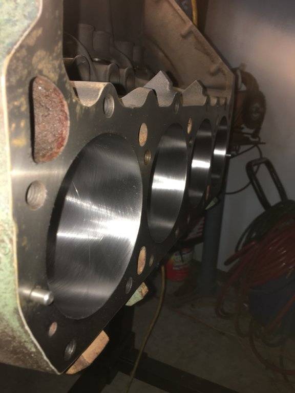

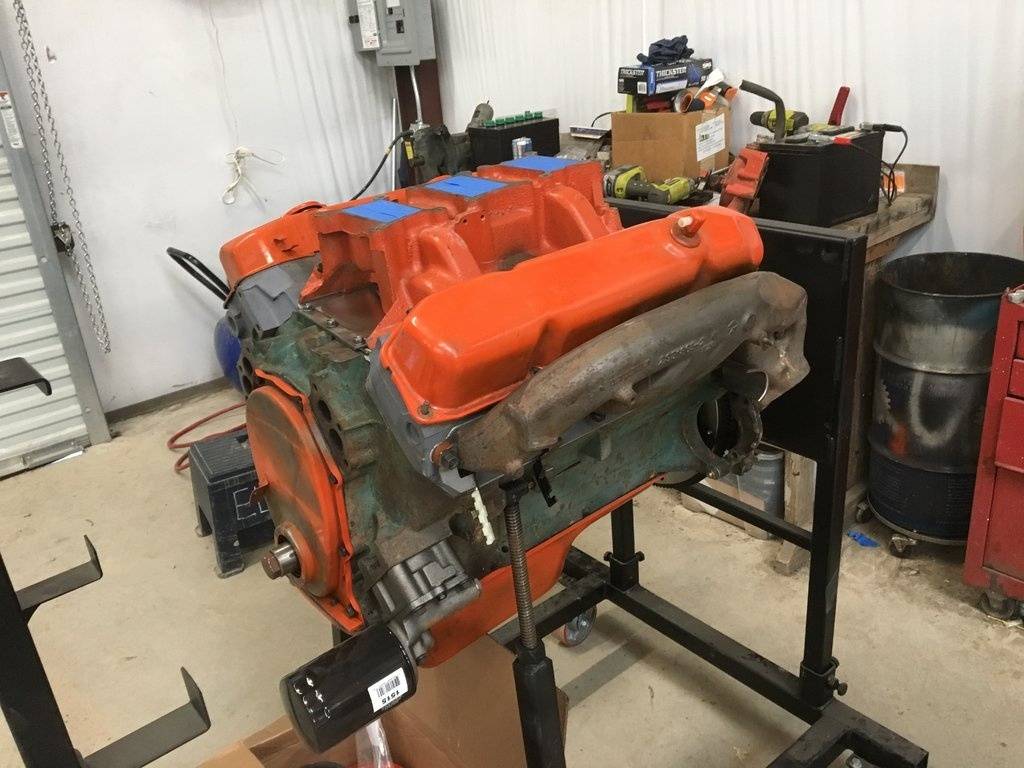

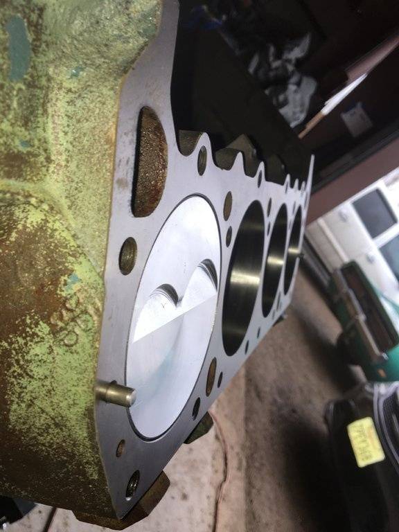

Better technology and weight in my six barrel cars pistons and rods along with smaller stem valves and better rods. Zero deck etc. little bowl work better springs Every bit helps.
