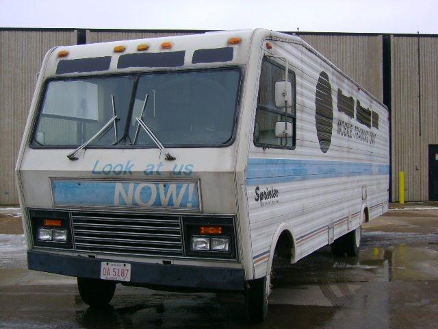

Otherwise, the thing is huge (26 ft) and I just plan on scrapping it. The attached picture is not the one I'm buying, but is the same model.

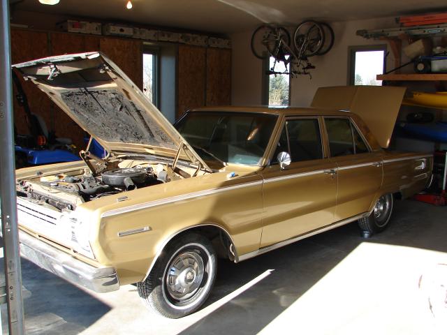

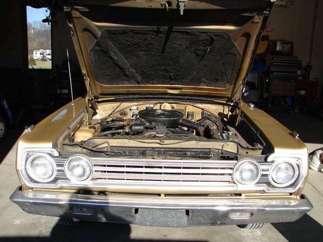

It's going into a rust free 4 door 67 belvedere that I'm converting to a stick shift bucket seats/console car with a 391 sure grip. With the big block, I may have to rethink the 391's. Here's a picture of the 440's future home.

Thanks for the compliment on the car. This was another purchase that didn't make the wife too happy, but it was so clean I didn't want to pass it up. I have a 68 sport satellite convertible and a 69 satellite convertible with neither being in too good of condition, and I intend to eventually make one good car out of the two. I started looking at AMD parts to fix one of them up, and it quickly justified the purchase price of this car. My inlaws live in Atlanta, so I did a lot of searching over Christmas and dug this up.
We just built a house, and I don't have my shop built yet to do paint and body, so I decided to have a little fun with the 4 door until I get ready to part it out. Everything I'm putting into it now will eventually go to the convertible.
