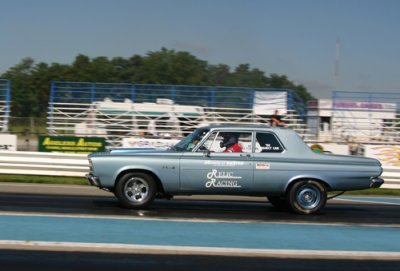

My old 440 was a pump gas eng that was in my 63 until I put the 493 in. It was a stock bottom end with KB quench pad pistons and 906 heads I ported. It came in right at 10.0 comp and I got quench with the KB pistons but its alot of work using them. I ran the MP .557 cam and a Holley Street Dominator intake with an 850 DP. In my 63 with a 9.5 Dynamic converter and 4.30's with a 30" tall tire it ran a best of 11.49 @ 116 at 3700 lbs. It would usually run 11.60's to 11.70's on normal days. Just thought you might want to know about it. Good luck with yours. Ron
