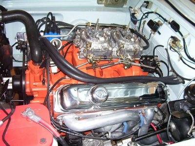

I usually go. i'm using the 5440 in my 65 coronet.
That is beautiful I cant wait to have mine together when i see pics like that!
