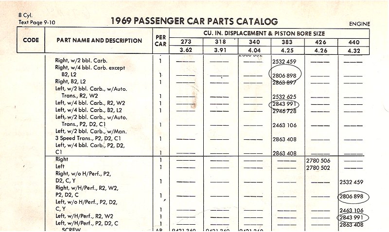

Be careful when buying B body BB "HP" manifolds. There is no such thing. Don't pay more than you need to. There are only 2 and 4bbl versions. The 4bbl version is the same for both LP and HP 383's and 440's. So any 4bbl car can be a donor for another.
I have to disagree with you. As your chart shows there are two different sets for the 4 bbl, one of which is the HP set.
