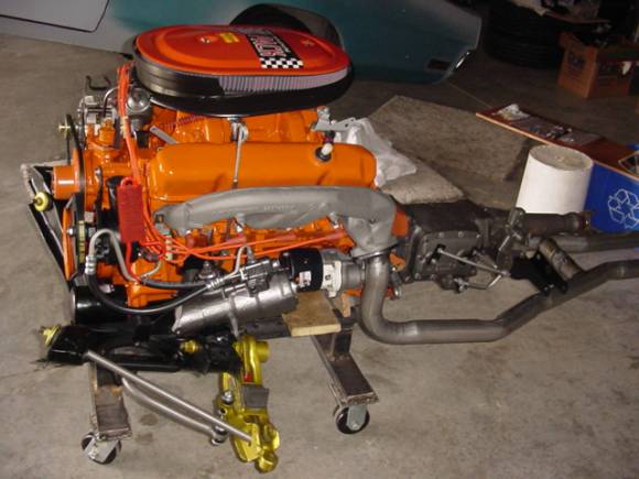

Hey , I had a similar problem, The lifters were the culprits. What are you running for engine oil? I was advised to go with Synthetic Amsoil 20-50 or Synthetic Royal Purple 20-50. Both with Zinc. Made all the difference in the world. Hope this helps
