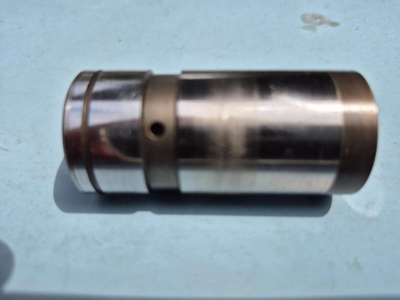

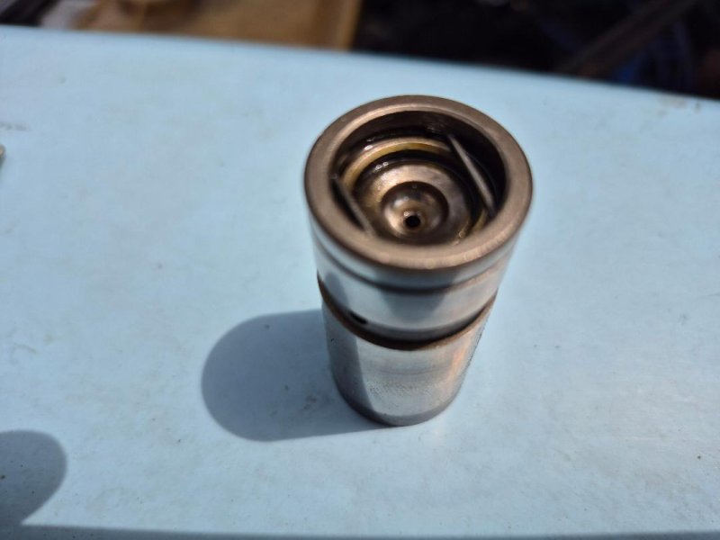

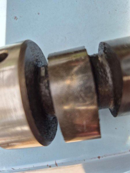

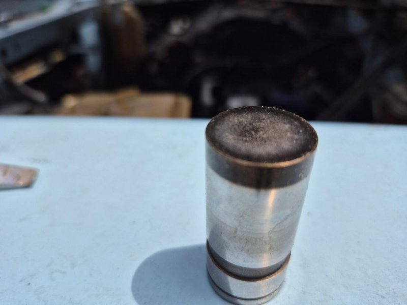

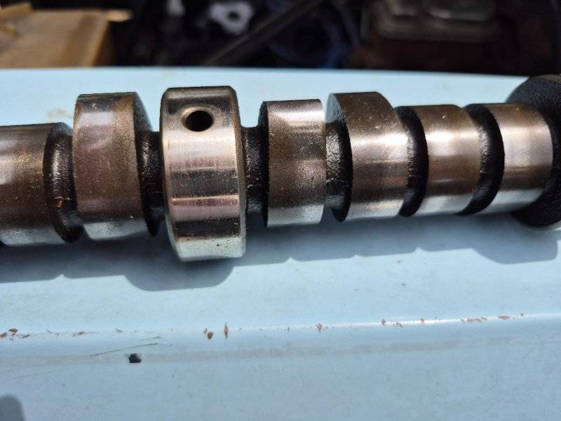

Here's some pictures of the lifter that was making the noise and the cam lobe. All looked good, the lifter has no marks and is still has its belly, I didnt take it apart yet but it has to be in the plunger or plunger spring.. the cam lobe look great no marks or uneven ware.. it has like 30,000 miles on it..
