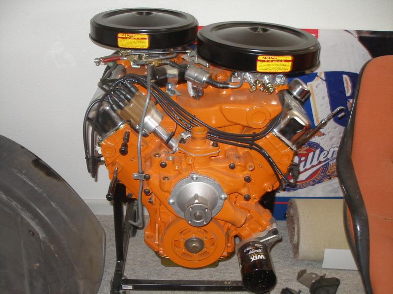

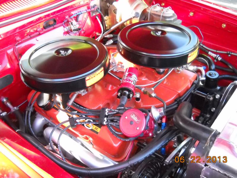

If I was trying to dress up a 440 to look like a Max Wedge I would make sure to have the crossram, avoid the Edelbrock or Indy heads that won't look right, and have metal fuel lines bent up that look orginal and avoid the braided steel fuel lines. I would think you could get it done for around $10,000 USD - $6000 decent 440 build + $4000 in Max Wedge goodies like the crossram, carbs, linkage, fuel lines, etc...

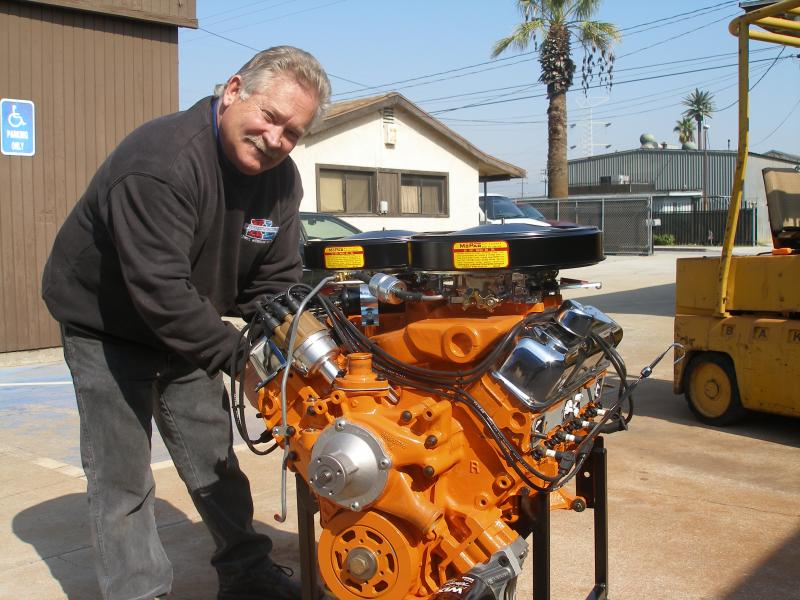

My 440 built Max Wedge with Dale Reed (Builder)
