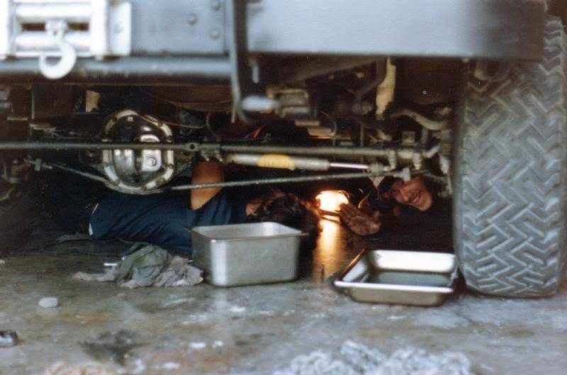

I don't remember what the pan looked like, even though I spent a lot of time under the thing.
