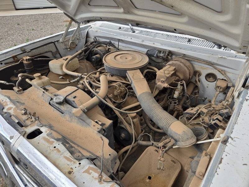

Had good, cold air on the ride home today. Sniffed for leaks and all the fittings and ports were negative. The listed r12 charge on the underhood label is 40oz, 80% of which is 32oz. So I hooked the gauges up and added a 12oz can to bring it to 30oz total. It seems to be working fine.
And here is my homemade battery hold down made from an old bed frame.
I guess I'm done under the hood.

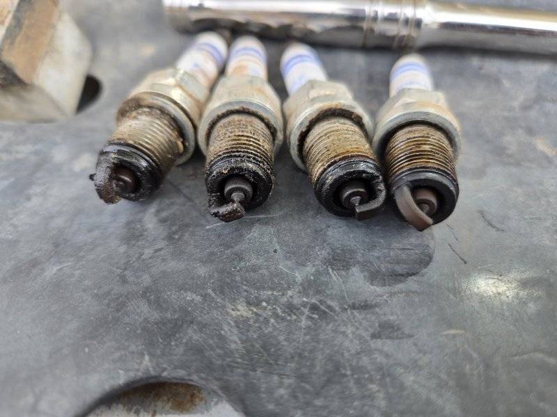

And I switched out the o2 sensor. The one that was in there was the one on the 5.2l that had oily plugs. I wasn't sure if it was damaged by the oil but the replacement was inexpensive enough.
