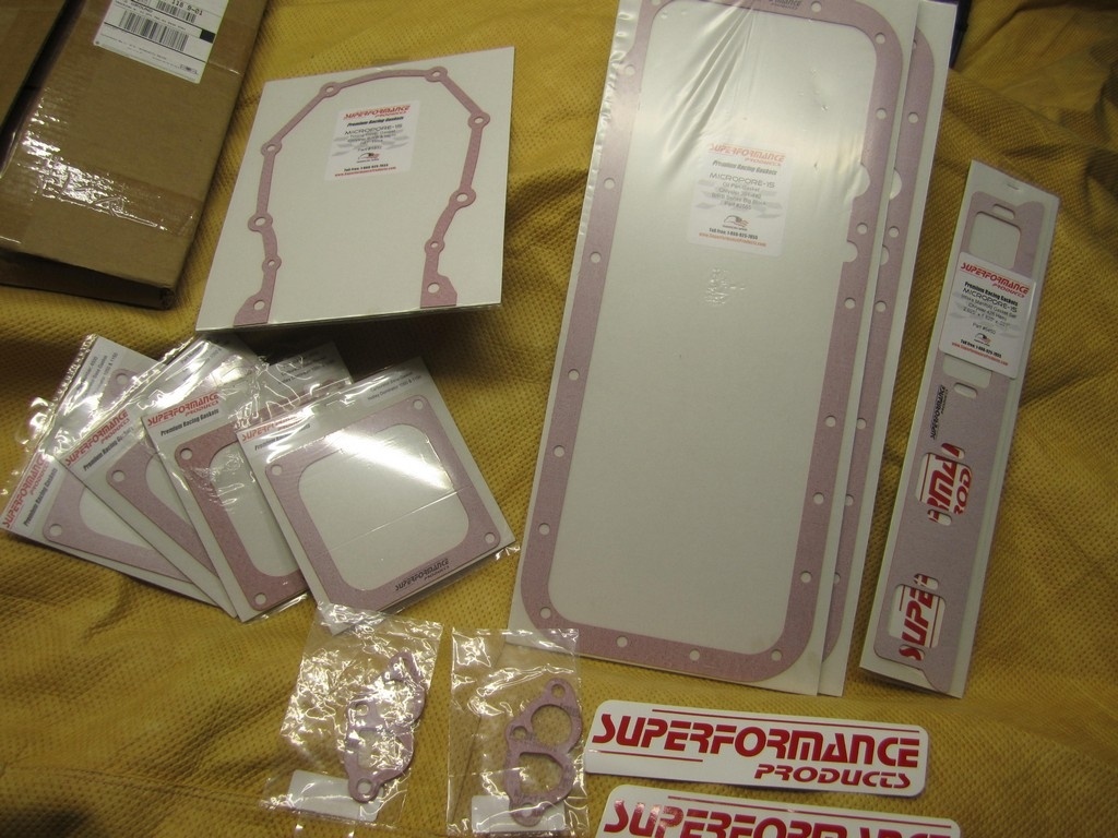

Installing all Gregs gaskets.2 oil pan,4 water pump,intake,valve cover,gear drive cover and carb base gaskets
I have now used the superformance gaskets on everything except the oil pan and have to say they have been the best gaskets I have ever used. I will not use anything else in the future because their stuff is that nice.
I've been thinking about that one for the next time I haul my engine out. Any issues? Does it seal up nice and tight?
About 4 years no leak then freshend up engine 2 years ago and reused and still no leaks, and I am picky as hell about leaks.
Originally used it becouse I was replacing the gaskets from Jack stands and one piece looked allot easier than three.
