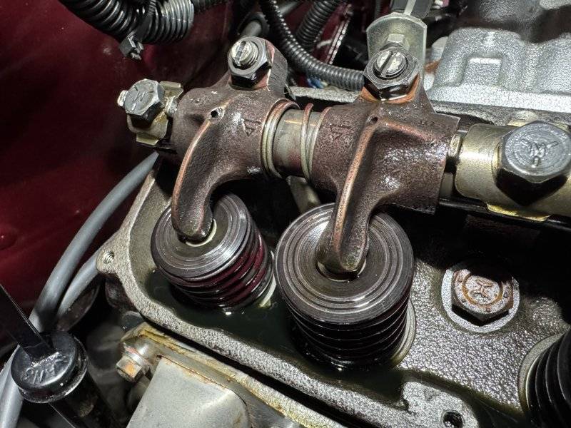

Hey guys, I have 906 cast iron heads and the old cork valve cover gaskets were getting pretty ratty so I thought I’d try the Moroso blue rubber gaskets…they leaked like crazy on both sides and I attributed that to the imperfections of the cast iron mating surface. So I’m back to a new set of Felpro cork gaskets and I also am having a hard time with leaks especially passenger side rear in the vicinity of #8….seeping out onto and down the headers - a topic that has been covered a million times. I applied some Permatex #2 so hopefully that problem is solved (I know there are dozens of possible solutions for this).
The main question is it normal to have so much oil pooled up around the #8 valves? When it’s running and oil is flowing I’m guessing it’s one of the the main reasons it’s leaking back there…there doesn’t seem to be any way the oil can drain back down…
The #8 spark plug also has some oil on it after it sits for a while - symptom of a bad valve guide seal?
I had a set of the Moroso blue gaskets and they leaked as if I had no gaskets at all. They decorate the wall now.
I put some fresh gaskets, Fel Pro fiber type, on my MP cast covers. Leaked like a mofo from around the lower bolts. It seems that there is a gap on the backside where oil collects and then comes out. Next time I have them off, got the sealed up for now around those holes, I'll get them stuck to the covers but fill in those open areas on the backside before putting them back on. Caulk in the gaps!
Yes
Right
Maybe.

Forgot to mention I’m running the Mopar cast aluminum covers. I used Permatex 2 to seal them and hopefully isn’t to hard to get it off since it doesn’t fully harden…
According to the packaging, the Moroso Silicone/Metal reinforced gaskets are designed for aluminum heads and cast valve covers, where you have two flat, machined surfaces to seal...
Yep that was clear when I started it…should’ve read first…gonna hang onto them though…eventually I’ll get some nice aluminum heads to keep them company…
Thanks. I had Edelbrock heads and MP cast aluminum valve covers and yeah....still had leaks.
The MP cast covers are notorious for leaks. I have had a few issues with rocker cover gasket leakage on a 3 different cars in recent years. No matter what gaskets, sealer or covers were used. I tried tightening to the point I had some threads that were pulling out. I had the most luck with using a bottoming tap and tapping the threads to the bottom of each hole and the using 1/4-20 studs with hex nuts and larger o.d. washers for more clamping force. Worked all 3 times on both sides to seal each car.
