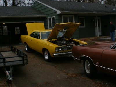

A&A Max Wedge intake, 2-600cfm Edelbrocks (manual chokes) = GREAT PERFORMANCE w/ NO PROBLEMS--LOVE THE LOOK AND THE "WOW FACTOR" WHEN I OPEN THE HOOD!!!

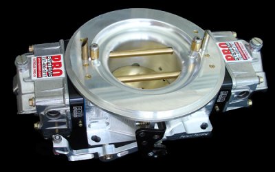

dla, I cant explain how exactly but I have been playing with these for a long time and trust me you will make more power with a tunnel and twins most days, ask anyone who races. I have gone from a single 1050 AED dominator (tuned) to these 2 TRE 950 carbs and without tuning I can feel a big change, my guess is 50+ hp extra, Im dynoing on Tuesday night so we will see.
Ask yourself this. Can you make more and less power changing intakes or spacers or ??
