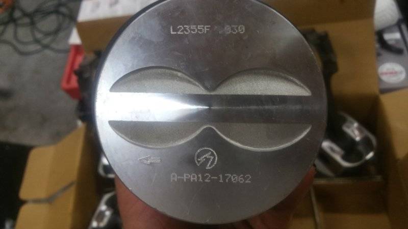

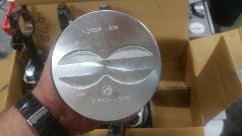

So I'm finally getting around to putting my 440 together but I've came across another snag. I assume the arrow on the piston tells me to point it towards the front of the engine but in doing so the writing on the piston would be upside down. Might just be my ocd kicking in but seems odd to me but then again to have the writing up right the arrow would be pointing towards the back. Also there 2 numbers on the pistons. 4 of them start with an a and 4 of them start with a b, any ideas on that? I tried to Google it but no luck. Thanks for the advice!
Mine was the same for the new pistons in my 340. Bothered me but checked everything and that's just how they were. Seems to be working fine.

dbl check and see if the pistons have offset pins offsets all go the same way not different side to side

Anyway, yes, arrows towards the front of the engine PLUS make sure when doing this your connecting rods are all facing the correct way (by checking numbers on rods + rod bearing direction as wyrm says) to make sure the pistons aren't on the rods backwards or something...it happens.

Arrow to the rear for less friction, due to offset pins in OEM or "replacement" pistons (NOT racing pistons). Old racers trick. You must either press them on the rods backwards or swap pistons side-to-side as you reverse them, to keep the oilers on the rods pointing to the opposite cylinder wall, as intended for skirt lubrication.

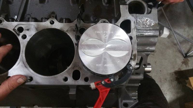

Pistons are correctly installed into the block ,machine shop had the rods on the pistons correctly too. Thanks for the education guys!
