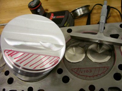

neither. quench dome pistons or change the heads.
I agree, you want a good quench/squish of around .040". Even with the 2.061 pistons and 906 heads, your at .021" below the factory spec deck. And with the 906 recessed squish area of around .120", .020 gasket, .021 below deck piston, you have a huge .161" of squish. With those 2.061 pistons use the closed chamber heads such as 915 or Eddys, with a .020" thick gasket would get you .041" squish. Or use a quench dome piston as lewtot suggested.
Read the United Engine and Machine tech bulletin on quench for some insight on whats going on in there when the plug fires, and the importance of good quench distance with todays gasoline.
