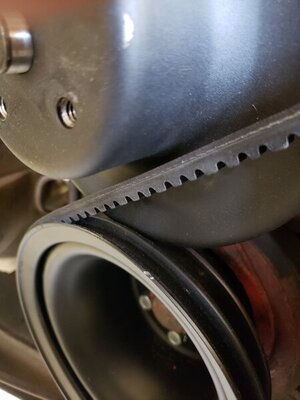

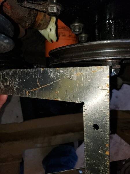

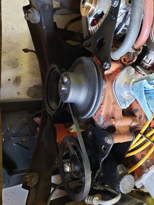

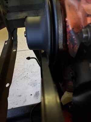

Here's some pictures, I think I know what my problem is, the power steering pump pulley needs to move up a little, I laid a square across the front of the crank pulley and it sat a little in front of the power steering pump, I bet that's my problem. What do you guys think?

Yeah, I've seen those belts clear under the snout of the fan pulley, but that looks like it touches. Can you moves the PS pump forward at all, even an 1/8th inch?
I think I should be able to put some washers or a spacer behind the bracket and get the pump moved out a little bit, it wont take much just a little to get it away from that edge where the snout starts.
I missed that, I was looking at the belt to pulley clearance.
