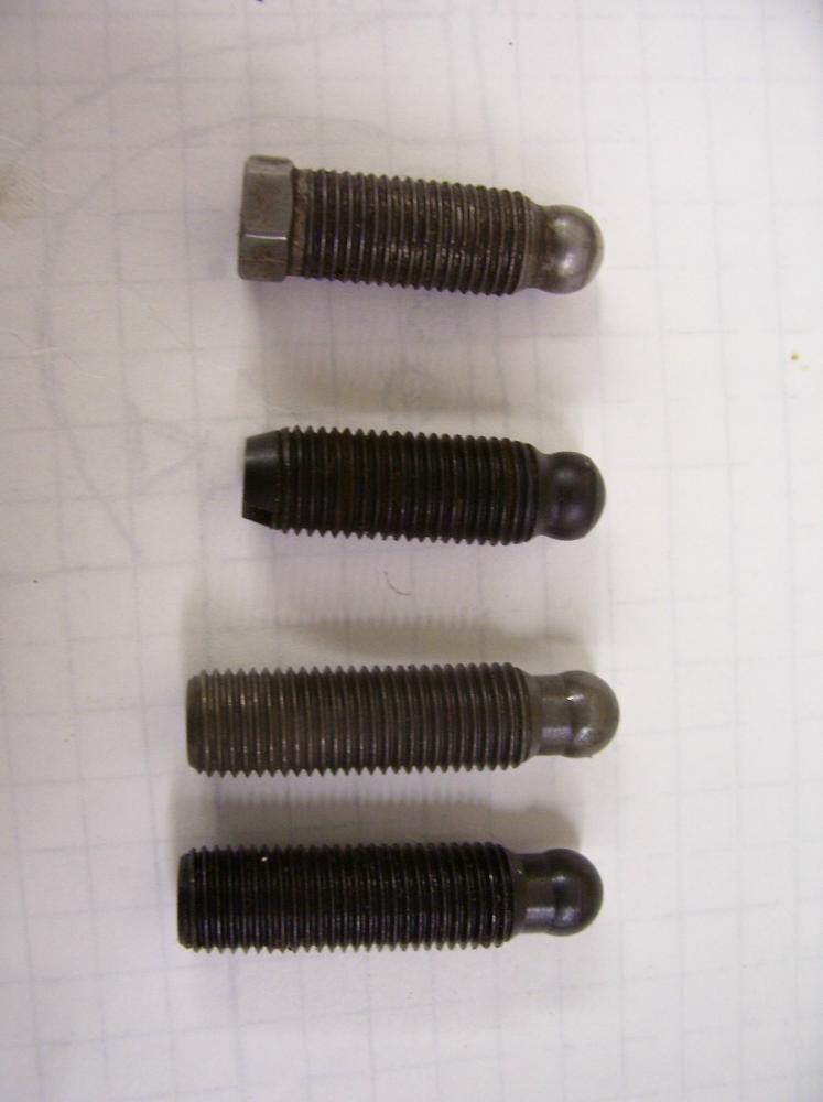

if I can get pictures together of the adjusters maybe it would be easier to understand.
there are four adjusters here. two early, too late. notice how the ball extends further on the two later adjusters.
I see what you mean. Ron
the top adjuster is the /6-318 one piece from back in the '60's.
the second from the top is the adjuster used in the '60's up into the late '90's. it has the screw driver slot with a jam nut and the ball really isn't completely circular. i believe this is the "2 thread showing" adjuster that is referred to in the engine books. letting the ball hang down a little made sense. back when this adjuster was first used, probably late '50's early '60's, .500" lift cams were unheard of.
the bottom two are the same and the ball is extended .100" which is equivalent to 2 1/2 threads with a 3/8-24 screw thread. extending the ball further will probably cause geometry and oil problems leading to breakage. pretty sure this is the adjuster everyone had problems with mainly because they were extending the ball too far, running high lobe lifts with high spring pressures. anyhow, i'd shoot for no threads showing with these. these adjusters have obsoleted the short ones. with higher lobe lifts more ball radius is needed.
