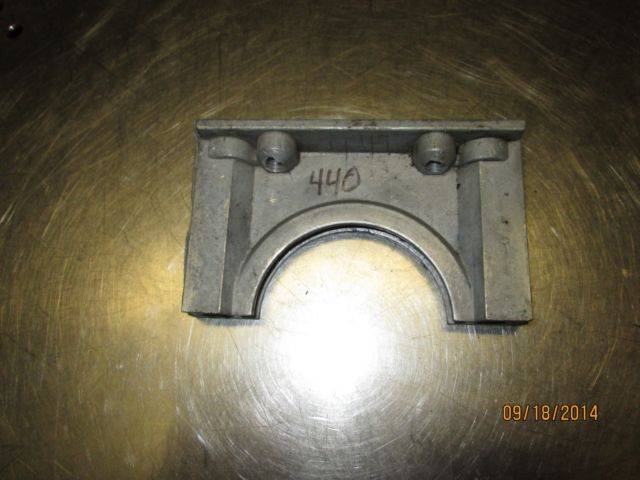

Do you know if it is leaking at the crankshaft interface, or is it leaking at the sides of the retainer where it seals against the block?
This thing....
No idea as of now. Motor is still in the car at this point; I will take a close look once its flipped over on the stand.

Hi tyallis, if no silicone was used in the block groove where the top half of the seal sits when you assembled the engine the seal is relatively easy to remove. Use a small wood dowel or aluminum rod to push on the end of the seal, once it moves and pops up on the opposite you can grab it and pull it out. Turning the crank may help with removal and installation. This operation can be done with only removing the seal retainer cap. Do not use a steel drift to push on the seal, even if you don't scratch the seal surface on the crank you have to be careful of the groove surface. As FrnkNsteen indicated check the end seals on the retainer cap, that's where my leak was. Hope this helps, Brian

In post#2 I like to kiss the 2 bumps where oil pan bolts are that face the number 5 cap. Friend had leak because they hit the cap.
Fran Blacker,
That must be why it is recommended to remove that main cap, when installing the lower RMS block?
