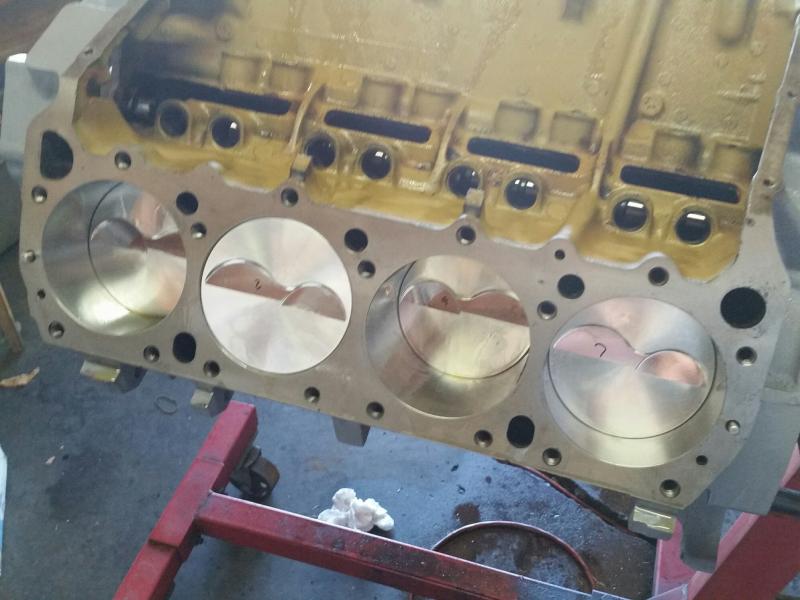

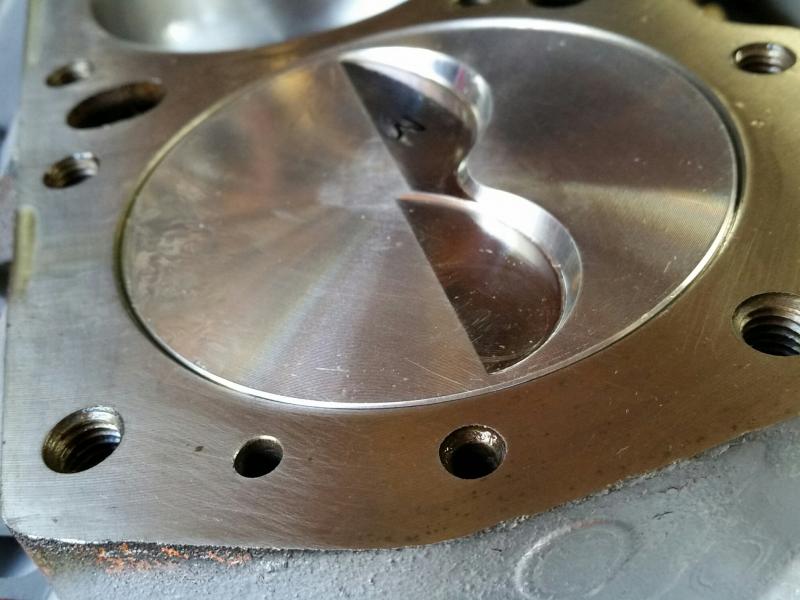

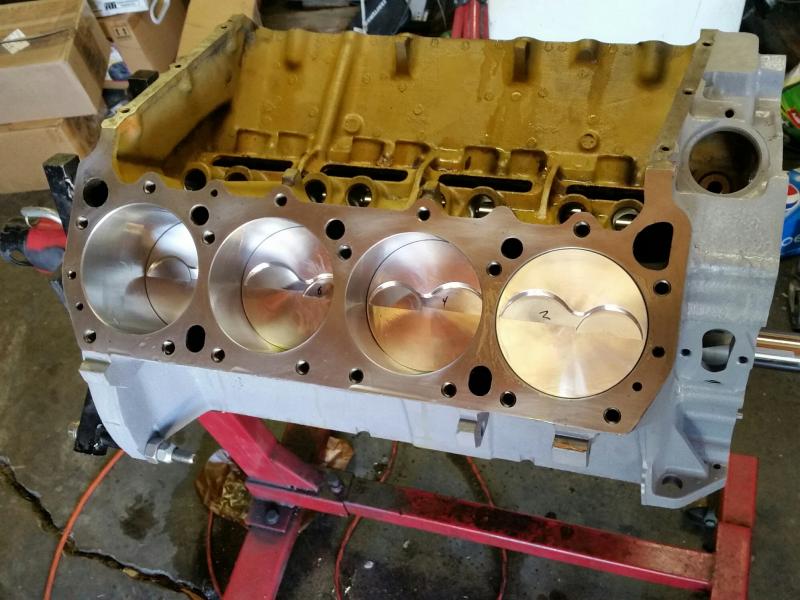

440 short block assembled, shes a tight one.
good deal !!!! keep us posted on your progress .

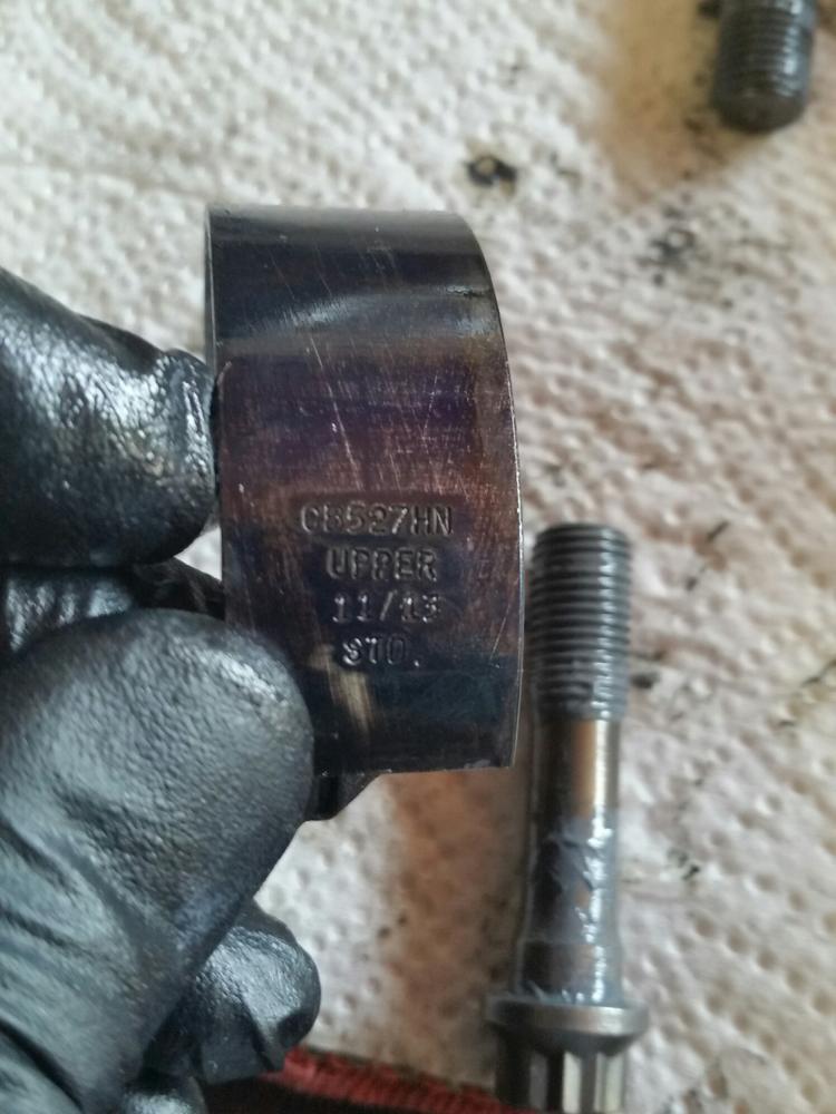

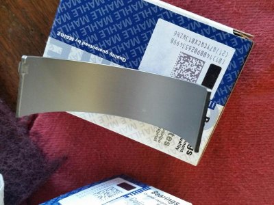

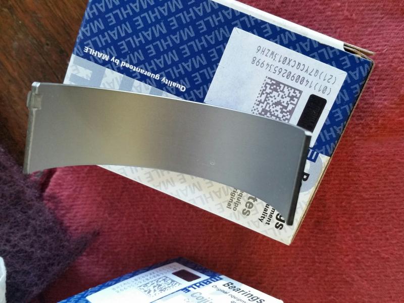

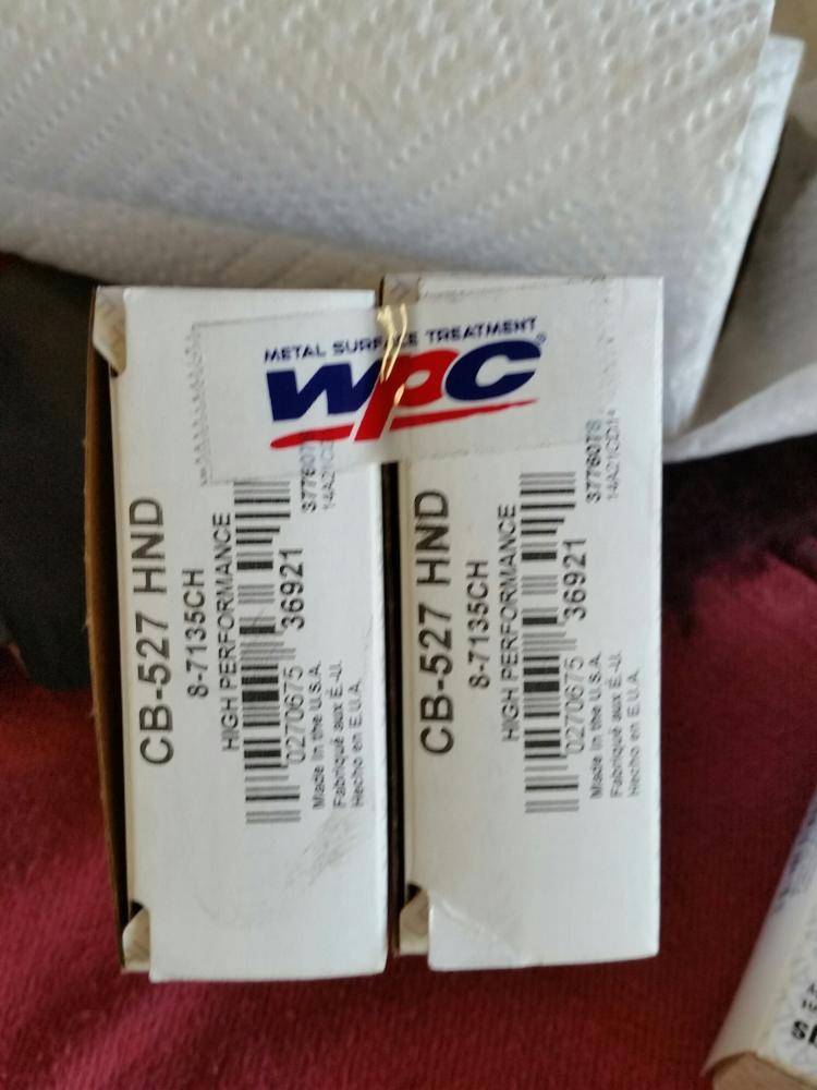

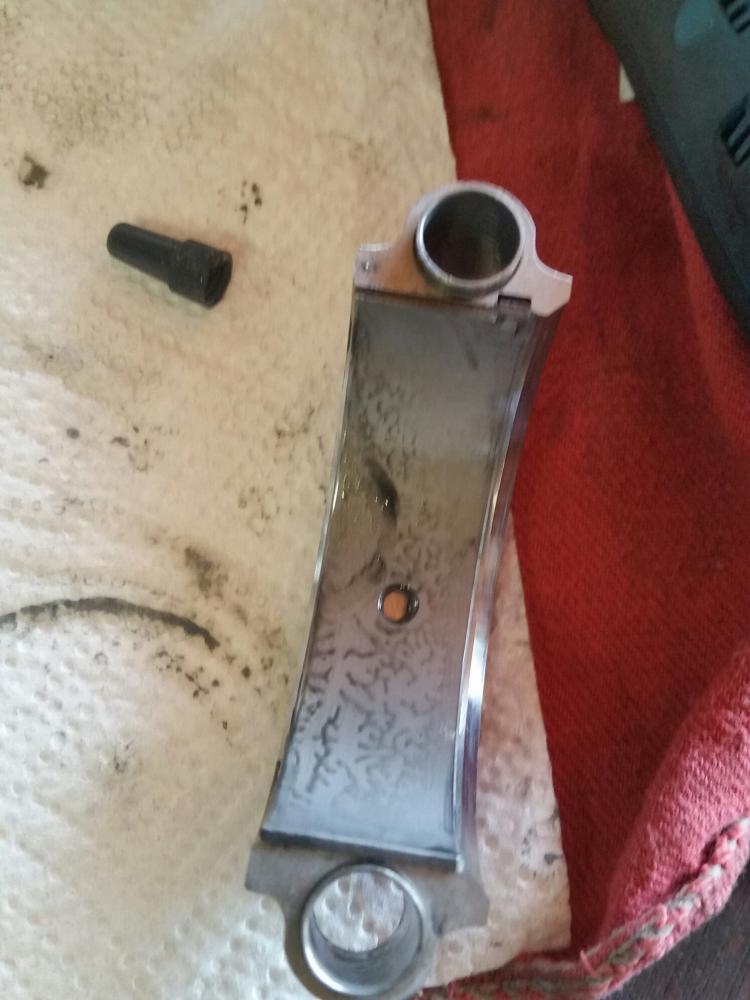

most all of my internal components have been treated with WPC surface treatment.
this has been on the Import scene for a while, and an NHRA little know deal for some time as well.
they have a US location now in Torrance California
List of parts that have been treated in my engine:
rocker shafts
rod bearings
main bearings
cam bearings
wrist pins
oil pump gears
oil pump drive shafts
piston skirts.
fuel pump pushrod
things that i could have done, but didnt.
cam journals
crankshaft journals
lifter bodies
pretty incredible stuff.

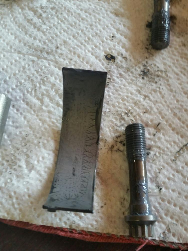

Got a newly rebuilt 440 in the shop some years back with the owner complaining about no oil pressure and couldn't find the problem and brought it in after doing the normal checks and oil pump replacement etc and after sticking in on the stand and pulling the pan, I found all the bearings installed upside down. With the engine turned over, it's pretty easy to do that if you're not paying close attention. Thing is, a reputable shop built this engine. Scary stuff for sure and it was too bad that no one noticed it before firing it up because it blackened all the rods and messed up the crank. You dodge a bullet for sure.....a lot of people do not check to see how much torque it takes to spin over a fresh engine.....

WPCs process is very Proprietary, i have never been able to actually watch the process.
what i do know is yes, the blast the parts with high pressure micro spheres of some sort of moly something product. it is shoot at a high enough presure that it dose restructure the surface of the part its applied to, but dose not change the bearing surfaces for oil clearance.
