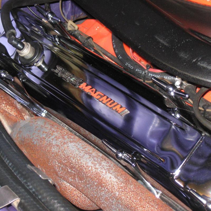

here ya go....40 buxx on ebay....fel-pro gaskets and a touch of bloo-goo.... got em on my 440 and my 383....aint leaked yet! 440 source is SERIOUSLY expensive!

Very nice, I may go with those ebay ones. Did they come with the t bar studs?
yeah they came with the t-bar studs. you may have to cut about 3/8 off the threads. i put a nut on...cut it.. geround the end to a semi-point....and threaded the nut off to chase the threads. they were a bit too long and bottomed out b4 they they could tighten.....hence the cutting! took about 10 minutes to do 12 :hello2:
