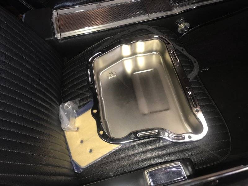

Mopar Performance Deep Transmission Pan, Chrome
No experience with that pan, but a couple points....
I like the thickness to add strength to the trans case.
I think the thick pan, without cooling ribs, will tend to retain trans fluid heat, compared to a steel pan.
If I had a GOOD trans cooler, I'd give it a shot for that money (if I didn't already have a deep pan). I'd just make darn sure the gasket surface was flat.
