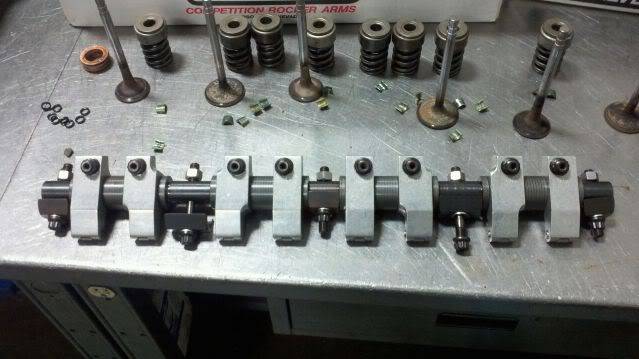

I did use them on one of my builds and had problems. I had notch out a part on my head to have them fit, they did not line up right, spent a lot of time setting them up with shims, etc. Also, they come with needle bearings, not a fan of needle bearings. Just my .02 cents, go with something that is bronze bushed, I did. RAS, but much more expensive and they double checked all before shipping, great crew there. I would look around, the lower cost steel ones on Ebay may not be bad, but never used them and they are made overseas.

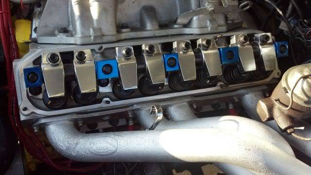

440 source rockers on a mild 512 ci with .550 inch lift.
Cost $215.
T and D rockers on my race engine with .750 inch lift.
$1250.

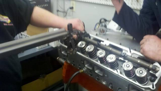

Changing springs on engine with heads on.
