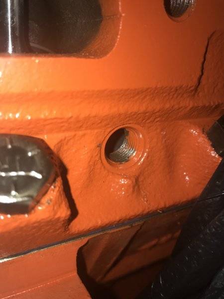

I have a set of 1978 452 heads. Does it take a gasket or tapered plug? Normal length? Any recommendations? The core didn’t come with plugs.

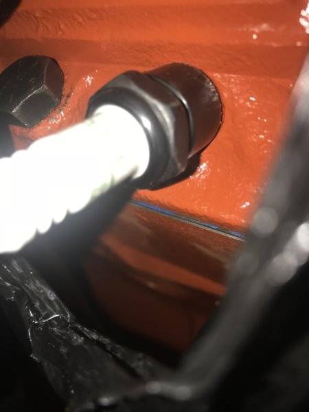

Looks like I need the narrow body plugs. These hit the block.

Looking at your first picture you need the tapered plug. I'll have to find the pics between the both. The "gasket plug" heads have a recessed hole.
You have the motor home heads, tapered plug, takes a 5/8" socket.
These are the 452 passenger car heads. Plugs with a ring or crush gasket. See the recess...
Here's yours...that nub is there so you don't use the wrong plug.
Double check this but I think if you look up a 440-3 engine you'll come up with the right plug. Check the thread depth before installing. Should be Champion RV12YC

'Motorhome' heads. Champion OBL9Y or equivalent--you can alter the heat range of course

not only the safety nub but you can see the raised passages for the cooling holes on each side of the plug compare both heads and see the differences
