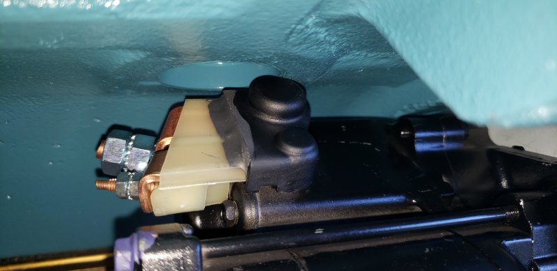

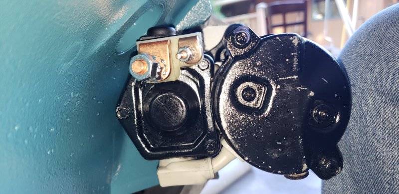

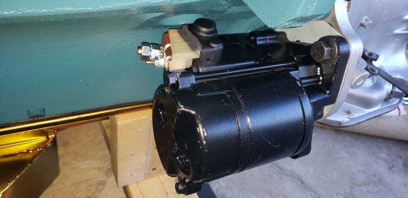

I just bought this Proform "Mopar" unit from summit. I actually like the way it sounds. Starts very quickly
Thanks for the heads-up! Are they built in the USA? Appreciate It!
I'm not sure, I liked it was all new parts and bought it mostly for that. I looked around a little and it doesn't seem to say made in USA anywhere which makes me think it's not.
I have only been using it a few weeks but so far so good.

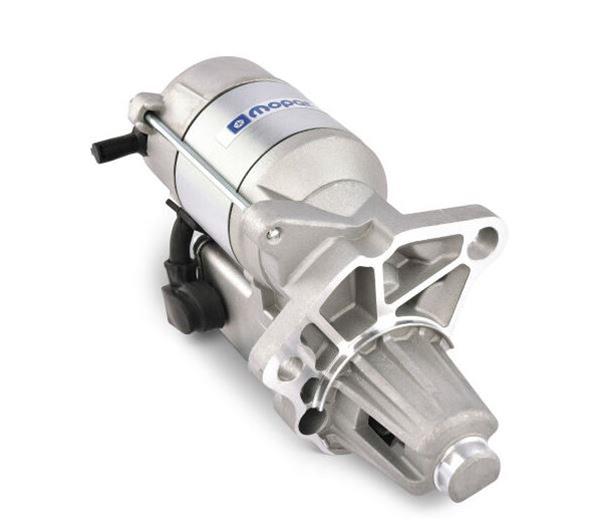

Using Rck Ato as a reference the mini starter was first used in 1988 on D150s and continued in use through 2002 on 1500s. There are 2 different versions as far as power goes. Some are 1.0 KW and some are 1.4 KW, but will fit the same vehicles. If you look at the specs for the Delco starter they sell as p/n 3361722 it says it is a Denso starter.
I got one from the local pull a part to put on my 70 GTX as the Summit headers won't let you use a full size starter.

There are alot of "new" Frankenstein starters out there so be careful! I think its 128000-1780??
