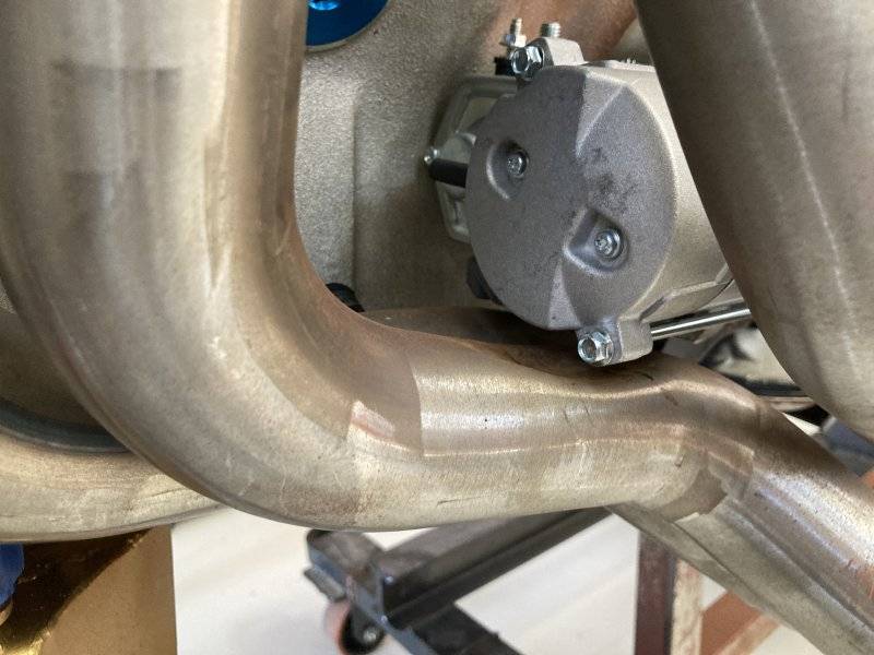

I have the 9523 unit which is clockable. I needed that one due to my bit of a hybrid application. Lucky for me the engine/trans is on a stand so it was way easier to find the best of the 4 positions available. I did need to use the plastic mallet on one tube to increase the clearance at the front. Since it's in a nest like yours, I was thinking about making a short extension harness to the starter for easier hookup when its in the car. Headers will get thermal coated which will help the heat issue some. May do an aluminum shield too.

I tried one of the factory mini starters on mine just to see if it would clear plus it would save me some dough. Nope. Only 2 units listed to clear my header/engine combo. 9523 Powermaster and the one from RobMc.

My engine is an all aluminum Indy unit. The block is a little bit wider than a normal oe iron one. It's the sister engine to the one Johnny Hunkins put in his "Violent Valient" from Popular Hot Rodding[ rip] and Mopar Muscle[ rip]. His was carb'd, mine is efi. TTI made a specific header for that engine to fit in the cars. My package is further hybridized because I'm using a 70 k-frame in a 65 car and using Schumacher adaptor mounts for Hemi mount to regular k-frame. One of the reasons I ordered the headers uncoated. I knew they would need some massaging here and there. I didn't want to ruin the thermal coating. I'm done working them over finally so in the future, I'll get them coated. On my 67 wagon w/440 and Hedman units, the Dakota/Ram/B Van starter works fine.
