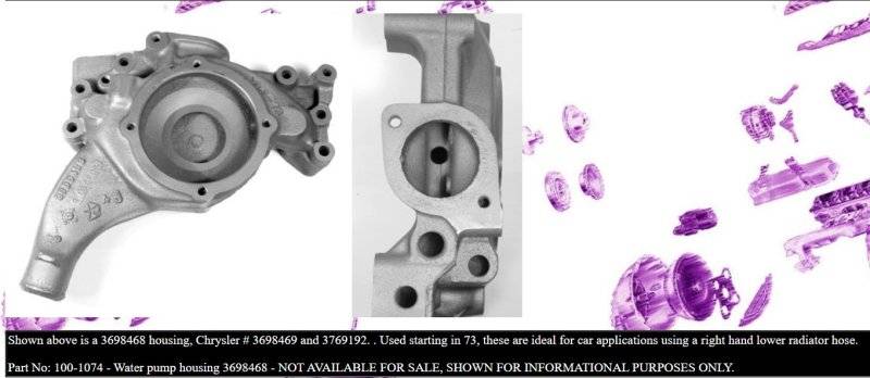

Attached is what my 3698468 looks like. I can buy these online sandblasted and clean.
The change was required to make space for the A.I.R. injection pump.
Thank you Kern that makes total sense! Rock Auto calls is the Air Smog Pump. That could make sense why it is not commonly made as perhaps they know the enthusiasts are not going to want the water pump housing and air pump because the air pump will decrease power and will not sell as well. That's the only thing I can think off as there should be a lot of these out there in use but don't see new OEM models for sale.

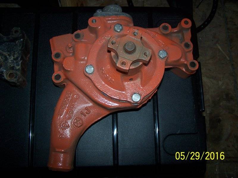

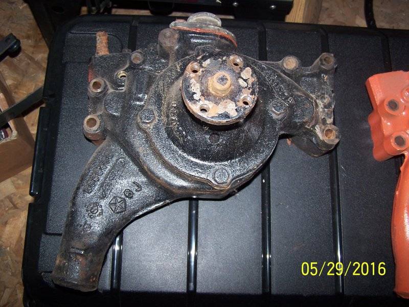

Thank you Six. Was curious , where did you find them? Did you work on '73 to '76 440 engines?
I did have occasion to deal with a few of those later 440's. I ordered a new truck in late 77 because I knew the 440 was going away and that 78 was the last year for them. I put a little over 500K miles on that truck so I had a couple engines in reserve in case I needed them. When I built my brothers 70 Challenger for my niece, I used one of the 440 engine for her car but it needed the earlier water pump housing so I have a couple of the right side outlet housing on hand. I sold my truck also so don't have a need for any of them anymore.
