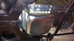

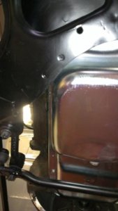

It's a 65 cross member I will attach a couple of pictures when I was build car k frame is not cut at all..first is the right side lots of clearance second picture is the left side clearance.. I can more pictures of it on car

KK, I saw those threads, and ended up confused anyway, so I posted in hope of coming away with a solution, but the wheels are still spinning. I'm starting to think I may grab a 7qt pan, and try to cut out 1"-2" of depth from the sump, to increase ground clearance, but it seems like a lot of work, for less capacity ? I think I should have kept my '69 Bee years ago, and retired Happy, and with some extra $$ in my pocket ! Thanks for the feedback & help on this...
If you are going the larger qt pan the milodon 31010 installed nicely on mine. I had to shave a little off the k member but that was mainly because I wanted the extra clearance. It hangs low so you could definitely take an inch out no problem.

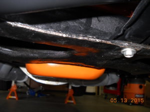

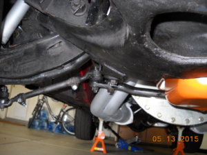

Someone asked how low the 440 Source 7 qt. pan sits. Here's a pic of my 440 with the 7 qt. pan installed. Car is sitting on rollers so its a little higher than it would be if it were sitting just on the tires. I trimmed just a touch of the crossmember for added clearance. Took all of 5 minutes to do.

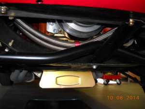

I made a small "L" shaped notch in the K member at the right front corner of where the pan sits. Maybe 3/4" front to back and 1 1/2" toward the driver's side, but don't even think that's necessary. New motor mounts so the engine sits up high enough would insure it clears. If you enlarge these pictures you can see the notch at the left, in this case with a 6 quart Mopar pan.
